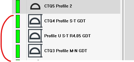

[Ke...] Posted October 20, 2025 Share Posted October 20, 2025 This is how my ANSI GD&T symbols appear I'm thinking it's a font issue but wanted to reach out for thoughts. Link to comment https://qualityforum.zeiss.com/topic/24807-gdt-symbols-do-not-appear-in-piweb-report/ Share on other sites More sharing options...
[Ma...] Posted October 20, 2025 Share Posted October 20, 2025 Did it appear on your setup at least once or it never showed up? If it was working and now it's like this, then restart Calypso Link to comment https://qualityforum.zeiss.com/topic/24807-gdt-symbols-do-not-appear-in-piweb-report/#findComment-140469 Share on other sites More sharing options...
[Ri...] Posted October 20, 2025 Share Posted October 20, 2025 I don't think the new GD&T symbols work in 2023. I believe this has been corrected though. Link to comment https://qualityforum.zeiss.com/topic/24807-gdt-symbols-do-not-appear-in-piweb-report/#findComment-140471 Share on other sites More sharing options...
[Ke...] Posted October 20, 2025 Author Share Posted October 20, 2025 You are correct! Running 2023 planning to update soon but waiting on IT. This is it in 2024. Link to comment https://qualityforum.zeiss.com/topic/24807-gdt-symbols-do-not-appear-in-piweb-report/#findComment-140475 Share on other sites More sharing options...
