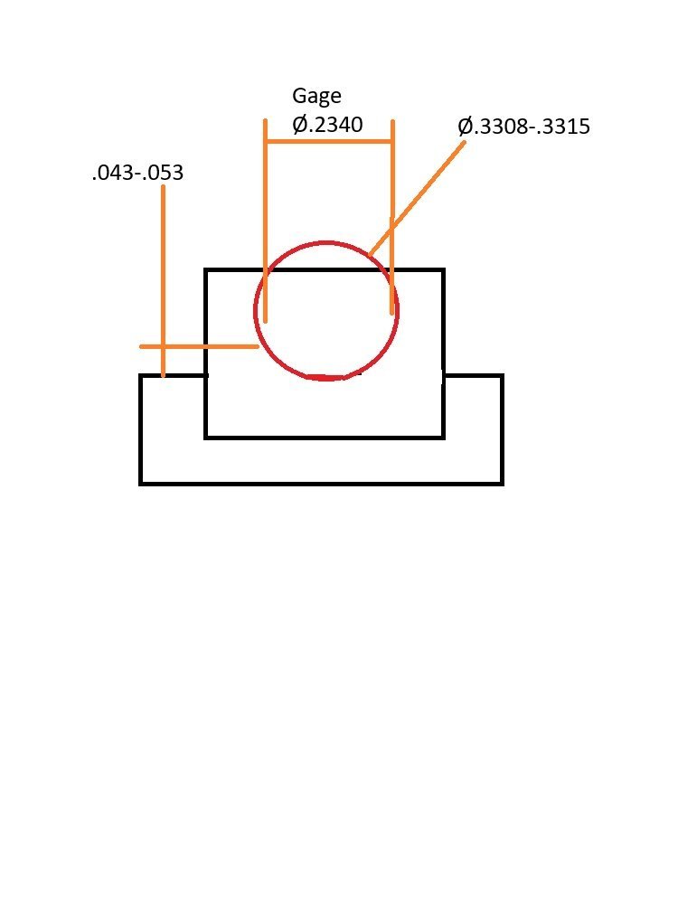

[Ri...] Posted October 21, 2025 Share Posted October 21, 2025 I am losing my mind. I thought I had completed this before in a place far, far away. I have a Sphere, and I need to set a gage diameter to establish the depth of the sphere from a plane. Assistance always appreciated. Link to comment https://qualityforum.zeiss.com/topic/24811-gage-diameter-in-sphere/ Share on other sites More sharing options...

[Pe...] Posted October 21, 2025 Share Posted October 21, 2025 Measure sphere, create theoretical cylindar with .2340 DIA with x and y inputs from sphere, and intersect them? should give you a circle (or two) that you can do distance to the plane. Link to comment https://qualityforum.zeiss.com/topic/24811-gage-diameter-in-sphere/#findComment-140525 Share on other sites More sharing options...
[Ri...] Posted October 21, 2025 Author Share Posted October 21, 2025 Thanks for the link, why my brain couldnt see intersecting a cylinder to the sphere would produce the depth, I can't say. 🤫 Link to comment https://qualityforum.zeiss.com/topic/24811-gage-diameter-in-sphere/#findComment-140527 Share on other sites More sharing options...
[FL...] Posted October 22, 2025 Share Posted October 22, 2025 (edited) How can I place an 8mm sphere( gage ball dia) in a cone to get the distance of the sphere to a plane? Edited October 22, 2025 Link to comment https://qualityforum.zeiss.com/topic/24811-gage-diameter-in-sphere/#findComment-140555 Share on other sites More sharing options...
[Ma...] Posted October 22, 2025 Share Posted October 22, 2025 Please sign in to view this username. You can try using intersections to get two opposing 2d lines and use tangential feature to place defined circle between them. Or if you can intersect cylinder with a cone to obtain a circle. But you have to calculate cylinders radius from actual cone angle to get correct touch radius. I have not tested fitting a sphere into measured cone data with restricted radius and tangential evaluation. Link to comment https://qualityforum.zeiss.com/topic/24811-gage-diameter-in-sphere/#findComment-140559 Share on other sites More sharing options...
