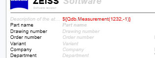

[Ch...] Posted October 22, 2025 Share Posted October 22, 2025 I have a couple questions about Local Versioning: 1. Is there a report header parameter that outputs what version the program was ran on? I want to know what revision of the program my data is from. 2. If I swap the CAD model on a new revision, do prior revisions still use the old CAD model? Looking at the file structure, it does looks like the old revisions do keep the old CAD model, but I want someone to confirm. I tried searching the forum but didn't seem to find an answer to my questions in the threads below. But sometimes I'm blind. Link to comment https://qualityforum.zeiss.com/topic/24833-local-versioning-questions/ Share on other sites More sharing options...
[Th...] Posted October 22, 2025 Share Posted October 22, 2025 Recent iterations of the standard report include a header line for the plan version. It's this red bit of text at the top. Link to comment https://qualityforum.zeiss.com/topic/24833-local-versioning-questions/#findComment-140645 Share on other sites More sharing options...
[Ky...] Posted October 22, 2025 Share Posted October 22, 2025 1. The revision is in there, I just can't find any PCM code to get it.... As Thomas mentioned, it is in PiWeb pretty easily which, if that's where you want it that's great, I just can't tell from your post. I also can't find it in hdr_txt table file. 2. Based on my testing, Calypso stores the CAD with the version, so going back restores the CAD that the version in question was made with. Link to comment https://qualityforum.zeiss.com/topic/24833-local-versioning-questions/#findComment-140649 Share on other sites More sharing options...
