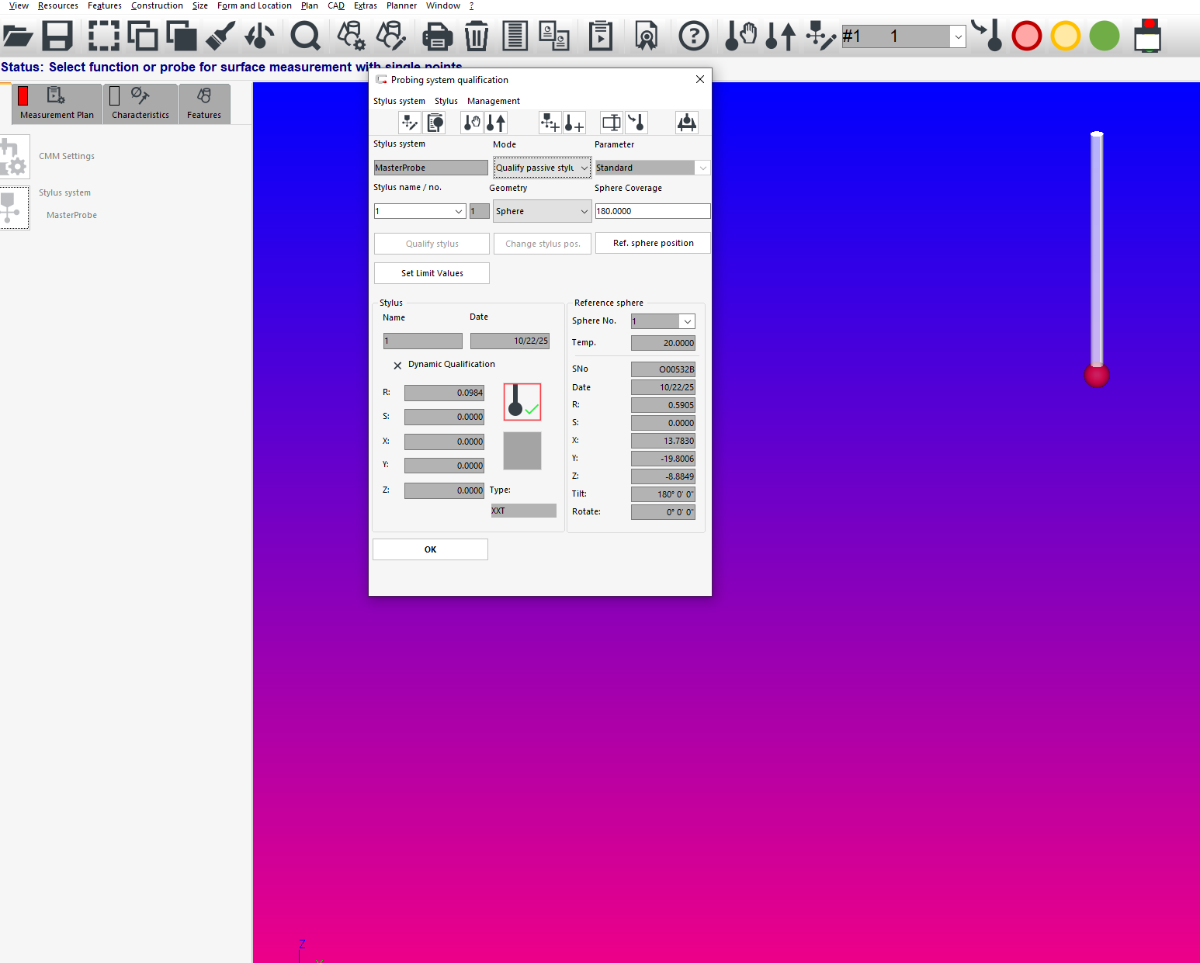

Fitting position
Can you try connecting in simulation? If you see the option in simulation, then it thinks there is something wrong with what it is reading from the controller.
You said you just replaced the RDS? Have you run the device activator (https://portal.zeiss.com/download-center/softwares/imt/software/9775). The other thought, and I hesitate to even mention it, is that we might have the wrong type of RDS....
