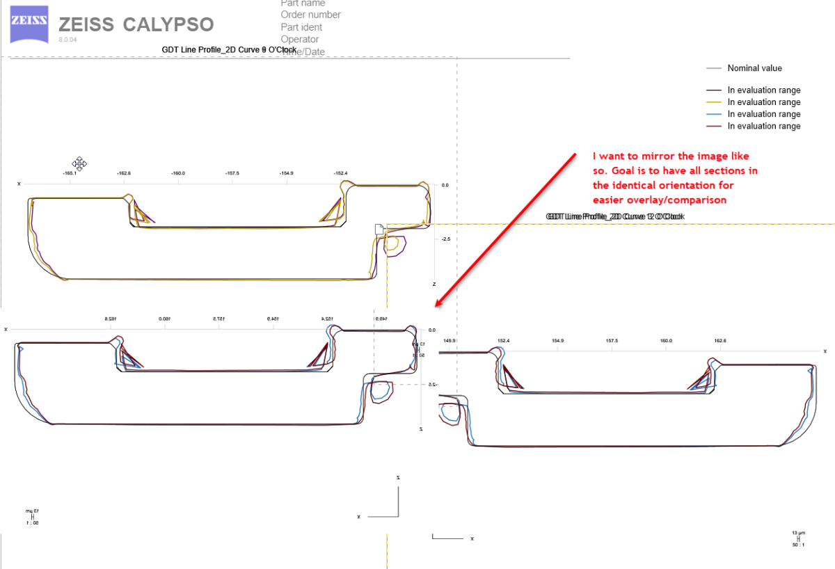

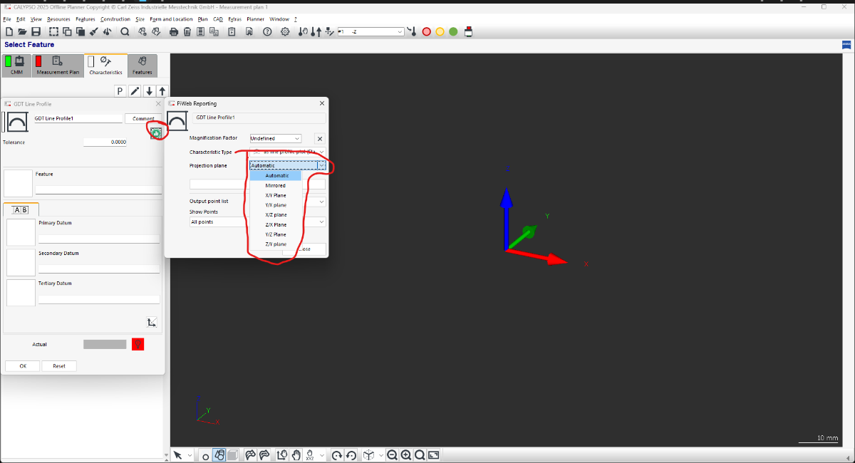

[Iv...] Posted October 22, 2025 Share Posted October 22, 2025 Hi All Hopefully, I'm just missing a simple feature in the PiWeb Editor. We inspect a washer-like part, where we measure 4 line profiles at every 90-degree increments. Sometimes we may bump this up to 8 or 12 sections. After engaging further with the customer, I got a better understanding of how they digest the part. Their preferred method is to evaluate all sections together in one overlay so they can easily compare the deviation across each section. I was able to produce the below. But my issue was that half of my plots were a mirrored image of the others. Is there an easy way to mirror the plots so they can all be shown in the same orientation? Seems like an easy ask, but I couldn't find any setting to flip orientations? Also, flipping the axis of the plot would correct the orientation to the desired result. Alternatively, while I still like to get further insight into the above. I'm not sure if this is the best approach... as mentioned, we measure parts with increased sections. Would there be a process in the PiWeb settings to ensure that those plots are always in the correct orientation? I would like to avoid programmers having to go into the template editor in PiWeb since they are familiar with the interface. I also considered that within the profile characteristic, we can apply a special rotation to the profile so that all profiles are in the same orientation. This would leave programmers in the Calypso realm, where they are more comfortable. Thoughts? Lastly, for the table of contents. Can you change the "In evaluation range" text to refer to the profile name instead? I really appreciate any help you can provide. Link to comment https://qualityforum.zeiss.com/topic/24841-piweb-profile-plots-mirroring-and-table-of-contents/ Share on other sites More sharing options...

[Iv...] Posted October 22, 2025 Author Share Posted October 22, 2025 Please sign in to view this username. Thanks for the response. I'm not sure if we are on the same page. My goal is to mirror some of the profile plots so that all profiles are in the same orientation, so I can perfectly overlay them. See below. For the table of contents, I was able to hide/add items but did not see a way to change the texts to a desired variable. Link to comment https://qualityforum.zeiss.com/topic/24841-piweb-profile-plots-mirroring-and-table-of-contents/#findComment-140665 Share on other sites More sharing options...

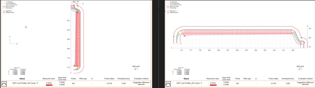

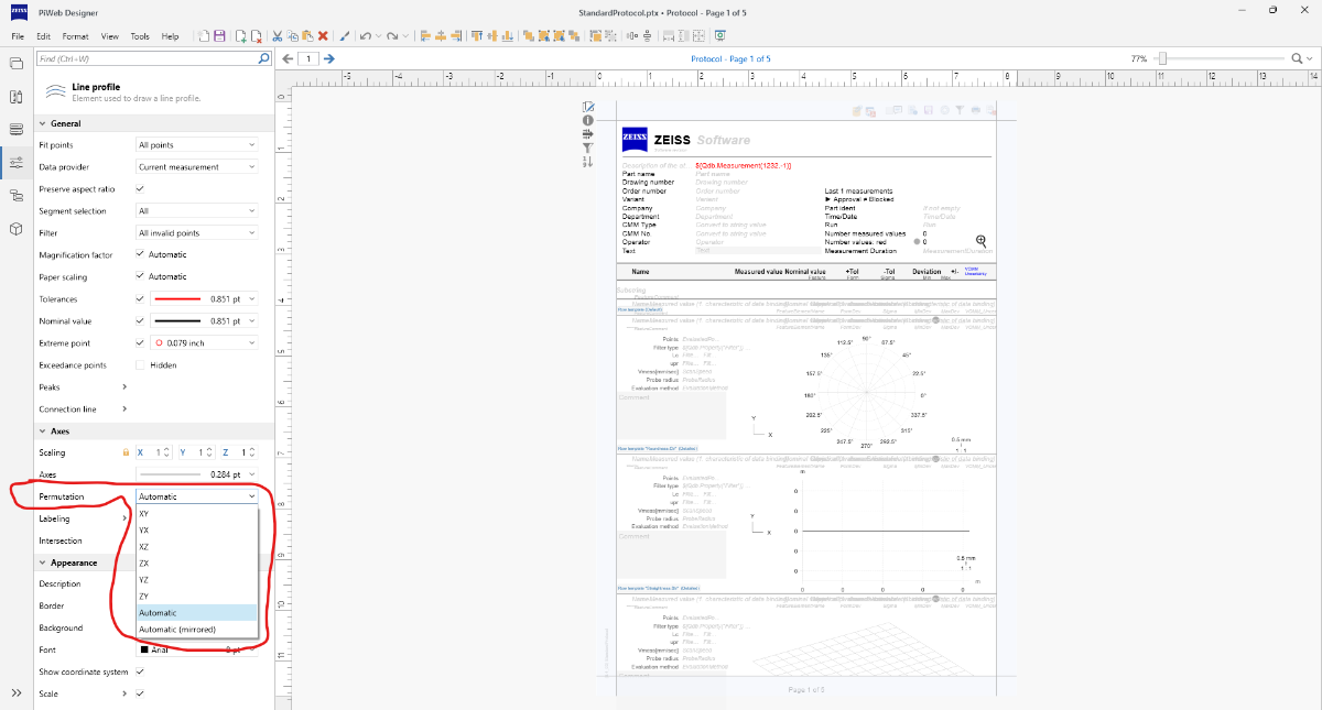

[Ri...] Posted October 22, 2025 Share Posted October 22, 2025 Martin, I believe you are looking at the coordinate system he put down in the bottom left. It does appear to be mirrored. You can change the Projection Plane on the Profile Plot. If you are doing it from Calypso side, you will see it directly in the Profile Characteristic when you click to Plot. If you are doing it from the PiWeb side, it is in the settings. Link to comment https://qualityforum.zeiss.com/topic/24841-piweb-profile-plots-mirroring-and-table-of-contents/#findComment-140671 Share on other sites More sharing options...
[Ri...] Posted October 22, 2025 Share Posted October 22, 2025 Calypso side. PiWeb side. Link to comment https://qualityforum.zeiss.com/topic/24841-piweb-profile-plots-mirroring-and-table-of-contents/#findComment-140675 Share on other sites More sharing options...

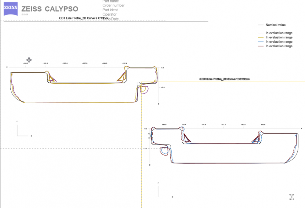

[Iv...] Posted October 22, 2025 Author Share Posted October 22, 2025 Please sign in to view this username. Thanks! I have tried that, but it does not mirror the plot in the way I would think or want. Below is what happens when I mirror the plot. Automatic produces the result on the left, mirroring it corrects it to the desired rotation. We generally have to go in and correct this, so I had already attempted this method to no success. Link to comment https://qualityforum.zeiss.com/topic/24841-piweb-profile-plots-mirroring-and-table-of-contents/#findComment-140677 Share on other sites More sharing options...

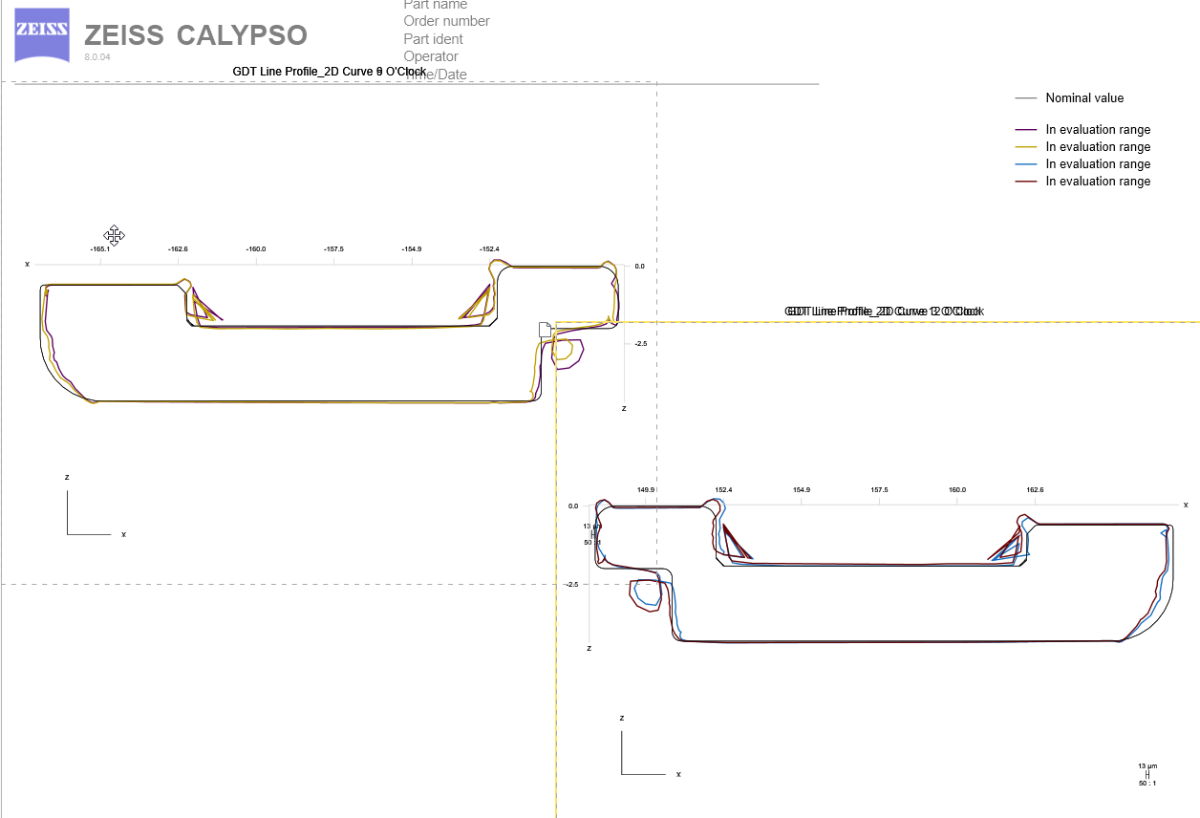

[Ma...] Posted October 22, 2025 Share Posted October 22, 2025 Please sign in to view this username. Oh i know only PiWeb version - i should finish our transition to new pc and new Calypso to find new possibilities. Please sign in to view this username. Would help evaluating on rotated alignment? I can not test it right now, but that it's only option. Create new alignment, leave it empty and just go to rotation. 1 Link to comment https://qualityforum.zeiss.com/topic/24841-piweb-profile-plots-mirroring-and-table-of-contents/#findComment-140685 Share on other sites More sharing options...
[Iv...] Posted October 22, 2025 Author Share Posted October 22, 2025 Please sign in to view this username. I can do a special rotation on the profile characteristic to complete the desired effect 😅 I knew that coming in, but I was hoping for an alternative method than modifying a characteristic because I was worried about influencing the results. I have tried the special rotation and have not seen any changes in the measurement output, so I think I'm okay. But because I viewed the mirroring of the plots as a superficial change, I was hoping for more of a superficial option to make this change. Such as the projection plane or mirror option. If anyone has suggestions on the table of contents and changing the labels, that would be appreciated. Link to comment https://qualityforum.zeiss.com/topic/24841-piweb-profile-plots-mirroring-and-table-of-contents/#findComment-140689 Share on other sites More sharing options...

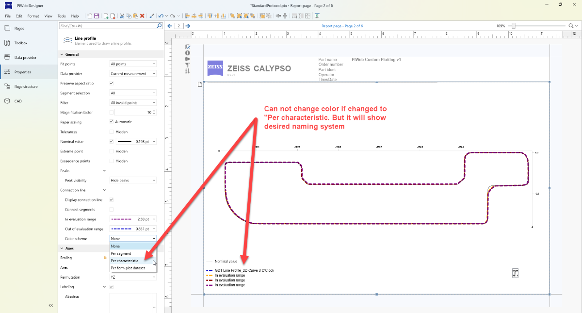

[Iv...] Posted October 23, 2025 Author Share Posted October 23, 2025 Quick update - using a special in the characteristic worked without any issues or changes to the measurement. I have the plots overlaid as desired, but I still have the issue with the table of contents. I thought I had found the solution when I changed the color scheme to "Per characteristic." It makes the name look great! However, PiWeb will not allow me to change the color... so all the profiles would be blue, and it would provide the contrast that is needed 🤮 I was able to change the line type (full, dash, etc.), but still not the contrast that I was looking for. The table of contents properties were very limited in what I could change. Link to comment https://qualityforum.zeiss.com/topic/24841-piweb-profile-plots-mirroring-and-table-of-contents/#findComment-140753 Share on other sites More sharing options...
