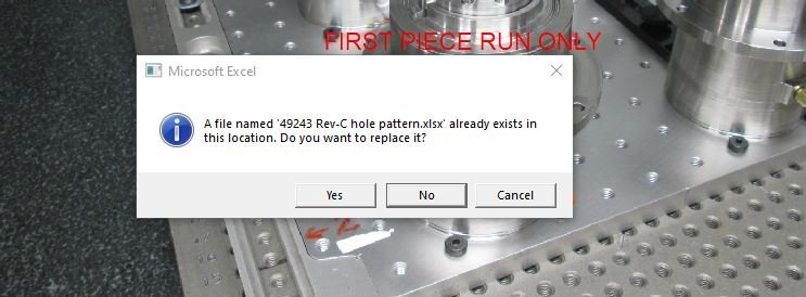

[Th...] Posted October 27, 2025 Share Posted October 27, 2025 Anyone else getting this error message. This pops up after every run and wont move onto the next pce in Autorun until you click yes, no, or cancel. Link to comment https://qualityforum.zeiss.com/topic/24883-a-file-name-already-exist-excel/ Share on other sites More sharing options...
[Tr...] Posted October 28, 2025 Share Posted October 28, 2025 Yes, I was receiving it after updating to Calypso 2024 and still got it in Calypso 2025. A process that was new to CALYPSO 7.8 and 8.0 that can cause "Table File" delays at the end of runs is CALYPSO's automatic output to excel via C:\Program Files\Zeiss\CALYPSO X.X\bin\Table2Excel. This tool is designed to take any Table File present and create an excel file however if you don't care to use this resulting excel file it can often lead to this error message randomly popping up at the end of programs. Try deleting or renaming the folder C:\Program Files\Zeiss\CALYPSO X.X\bin\Table2Excel and it should fix itself. 1 Link to comment https://qualityforum.zeiss.com/topic/24883-a-file-name-already-exist-excel/#findComment-140951 Share on other sites More sharing options...
[Th...] Posted December 15, 2025 Author Share Posted December 15, 2025 It worked, Thanks! Link to comment https://qualityforum.zeiss.com/topic/24883-a-file-name-already-exist-excel/#findComment-143695 Share on other sites More sharing options...
