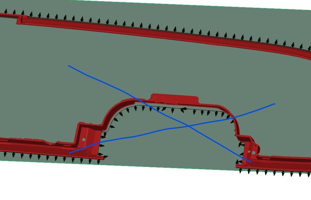

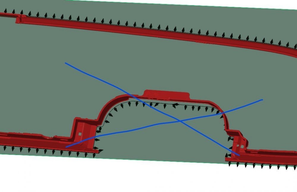

[Ma...] Posted October 28, 2025 Share Posted October 28, 2025 I have a frame and would like to measure its length. I've created a silhouette, but I don't want to measure the inner part. Is there a way to manually edit the silhouette and remove individual points? Link to comment https://qualityforum.zeiss.com/topic/24887-edit-silhouette/ Share on other sites More sharing options...
[Na...] Posted October 29, 2025 Share Posted October 29, 2025 Hello Maria, you can use "construct section from points" and select on the section without the inner part (ZEISS Quality Tech Guide). Maybe deselecting the inner part during the creation of the silhouette will also work for you, but the silhouette will still be created at the edge of your selection. Nanno Link to comment https://qualityforum.zeiss.com/topic/24887-edit-silhouette/#findComment-141057 Share on other sites More sharing options...
