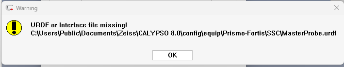

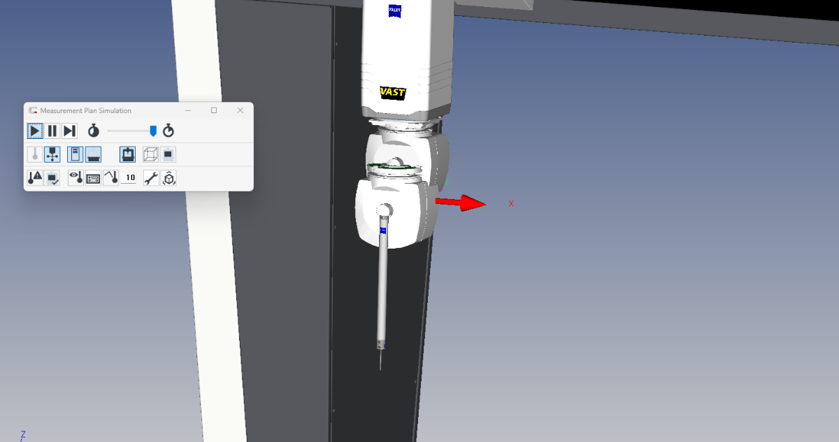

[Sh...] Posted October 28, 2025 Share Posted October 28, 2025 I'm getting an error in Planner for Calypso 8.0.0404 when using the MasterProbe...It will not show the model and it seems that other probes like ZAS are a bit off the head. Link to comment https://qualityforum.zeiss.com/topic/24893-calypso-80-planner-masterprobe/ Share on other sites More sharing options...
[Ri...] Posted October 28, 2025 Share Posted October 28, 2025 Try recreating the MasterProbe in SSC, and name it something different, and see if that helps. Link to comment https://qualityforum.zeiss.com/topic/24893-calypso-80-planner-masterprobe/#findComment-140967 Share on other sites More sharing options...
[Sh...] Posted October 28, 2025 Author Share Posted October 28, 2025 No dice 😞 Link to comment https://qualityforum.zeiss.com/topic/24893-calypso-80-planner-masterprobe/#findComment-140981 Share on other sites More sharing options...
