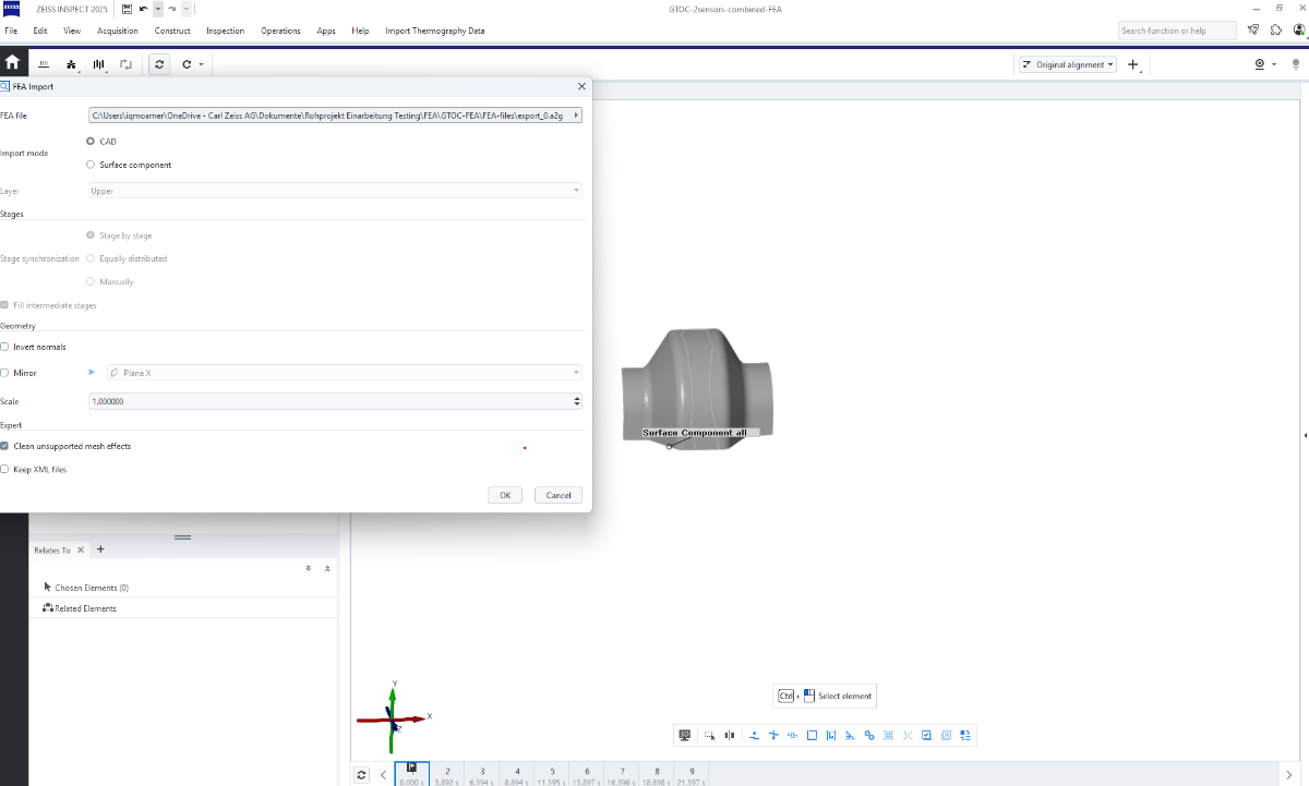

[Ra...] Posted October 29, 2025 Share Posted October 29, 2025 Hi all, I am trying to import Finite element strain data and compare with the strain data in the Zeiss correlate dic strains. (for FEA validation) Please provide any insights of how to do the comparison with the possible steps. Many thanks in advance. Best regards, Raja Link to comment https://qualityforum.zeiss.com/topic/24903-how-to-import-the-fea-data-and-compare-with-dic-data/ Share on other sites More sharing options...

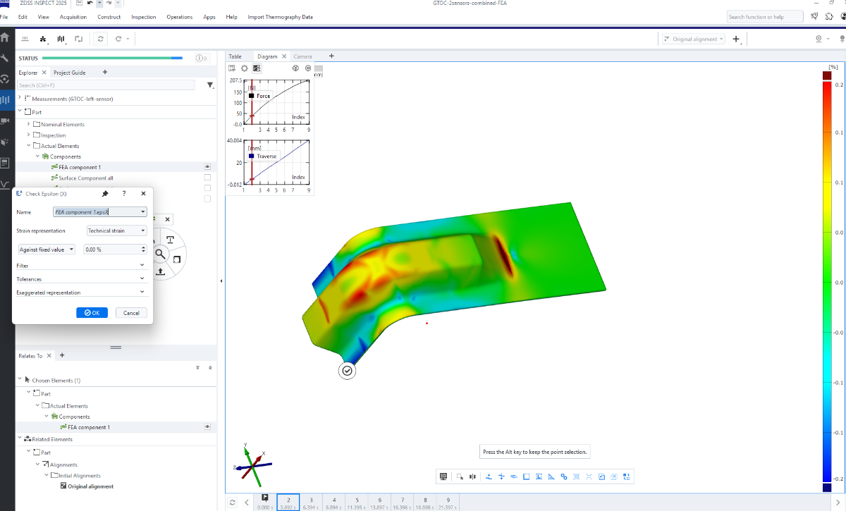

[Mo...] Posted October 30, 2025 Share Posted October 30, 2025 Hallo Raja, With the FEA app (available in the SW Store), you can import the exported FEA file into Zeiss Correlat as a CAD file or surface component, as shown in the attached figure. You can then perform the necessary checks on this imported surface component. Accessing the SW Store through our Zeiss Quality suite SW. Best regards Mohamed Link to comment https://qualityforum.zeiss.com/topic/24903-how-to-import-the-fea-data-and-compare-with-dic-data/#findComment-141119 Share on other sites More sharing options...
