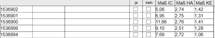

[DI...] Posted October 29, 2025 Share Posted October 29, 2025 Hi, is it possible to hide a table row (not the whole table) inside PiWeb Monitor (doesnt matter if hiding for monitor or printing). I attached a screenshot. I want to hide either in Monitor or for printing one or more rows. Link to comment https://qualityforum.zeiss.com/topic/24913-hide-row-in-a-table-piweb-monitor/ Share on other sites More sharing options...

[DI...] Posted November 4, 2025 Author Share Posted November 4, 2025 I found a workaround for my problem. Maybe somebody has a more efficient solution. Instead of hiding a single row in a table (by addressing the table), I work with text boxes which have a designated place in a template. Those text boxes are set to have a white background and i hide them in Monitor and for printing via check box interaction. Using the following approach: https://techguide.zeiss.com/en/zeiss-piweb-2025r1/article/dynamic_output_in_piweb_monitor_piweb_designer.html These text boxes (if shown) will hide a row. Rows are located in the background. Link to comment https://qualityforum.zeiss.com/topic/24913-hide-row-in-a-table-piweb-monitor/#findComment-141379 Share on other sites More sharing options...
[Do...] Posted November 12, 2025 Share Posted November 12, 2025 It is not possible to hide table rows. The layout of the table is not affected by the visibility of the row. You must filter the entities beforehand. Use the advanced filter. For more information, see the technical guide. Link to comment https://qualityforum.zeiss.com/topic/24913-hide-row-in-a-table-piweb-monitor/#findComment-141777 Share on other sites More sharing options...
