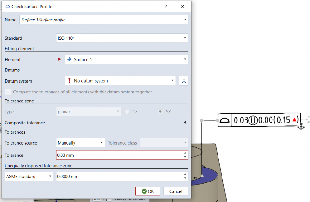

[Ti...] Posted January 17, 2023 Share Posted January 17, 2023 If you have a callout like this: Surface Profile 0.03 U 0.0 A|B|C It means that no more material can be added to the profile, only material can be subtracted. How do you set this up inside GOM? Do you put the 0.03 in the tolerance setting, then use the 'Unequally disposed' setting and add 0.03 or -0.03? Or would you put nothing in the tolerance setting and just use the 'Unequally disposed' setting? Does this change if you are measuring an internal or external feature? Thanks. Link to comment https://qualityforum.zeiss.com/topic/2492-unequally-dispose-surface-profile-asme/ Share on other sites More sharing options...
[Ch...] Posted January 17, 2023 Share Posted January 17, 2023 Hi, see the following screenshot Hope this helps. Best regards. Christoph Link to comment https://qualityforum.zeiss.com/topic/2492-unequally-dispose-surface-profile-asme/#findComment-6512 Share on other sites More sharing options...
