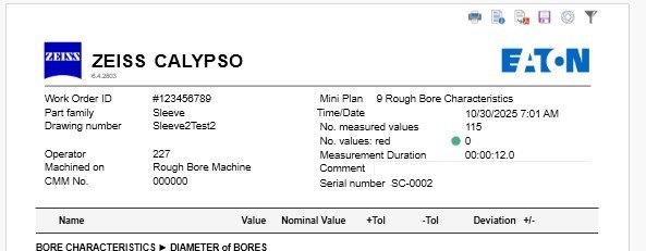

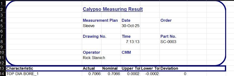

[Ri...] Posted October 30, 2025 Share Posted October 30, 2025 (edited) I am trying to pass the Drawing Number from PiWeb to Excel when it is created, I know I can add "Drawing No." to the "Input Parameter" dialog box, but it has to be a variable and that box doesn't allow formulas. Any assistance is appreciated. Edited October 30, 2025 Link to comment https://qualityforum.zeiss.com/topic/24929-how-to-get-drawing-number-from-piweb-to-excel-xlt-file-when-created/ Share on other sites More sharing options...
[Ky...] Posted October 30, 2025 Share Posted October 30, 2025 Hey Richard, So, how are you getting the value into PiWeb? If you are just worried about setting up a formula for the drawingno, you can use PCM in the pre/post settings (if you have the license somewhere) or put it in a formula for the comment of a characteristic or in a text element. The command would be setRecordHead("drawingno",VAL), where VALis whatever you calculate the drawing number to be. Link to comment https://qualityforum.zeiss.com/topic/24929-how-to-get-drawing-number-from-piweb-to-excel-xlt-file-when-created/#findComment-141175 Share on other sites More sharing options...
[Ri...] Posted October 30, 2025 Author Share Posted October 30, 2025 Unfortunately, I am not PiWeb smart, I hardly understand it. This template was most likely created by Zeiss about ten years ago (Calypso v2017). A little digging and I found a variable tied to u_pPartNumb. setRecordHead("drawingno",PN) This put the value on the Excel sheet. Thank you. Link to comment https://qualityforum.zeiss.com/topic/24929-how-to-get-drawing-number-from-piweb-to-excel-xlt-file-when-created/#findComment-141187 Share on other sites More sharing options...
[Ky...] Posted October 30, 2025 Share Posted October 30, 2025 Ah, okay. Looks like the part number might be a custom header field. If you're okay with what you have now, that's fine. Otherwise, this document covers how to add that "u_pPartNumb" or whatever to the ReportINI and add it to the excel file. https://portal.zeiss.com/knowledge-base?id=1664567 1 Link to comment https://qualityforum.zeiss.com/topic/24929-how-to-get-drawing-number-from-piweb-to-excel-xlt-file-when-created/#findComment-141195 Share on other sites More sharing options...
