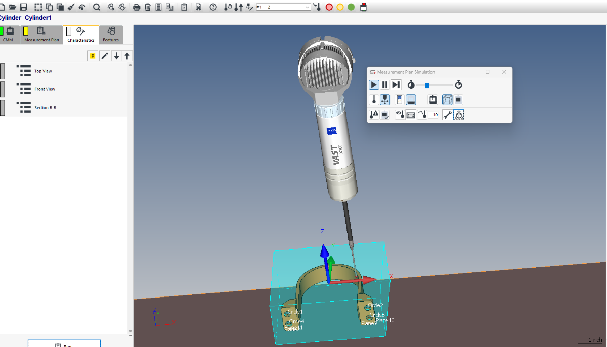

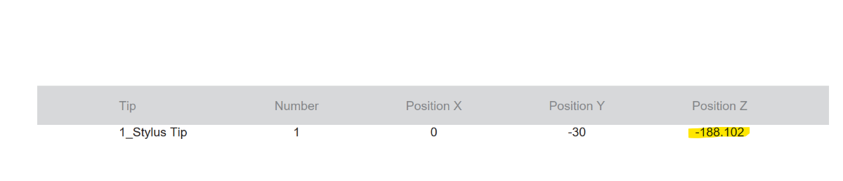

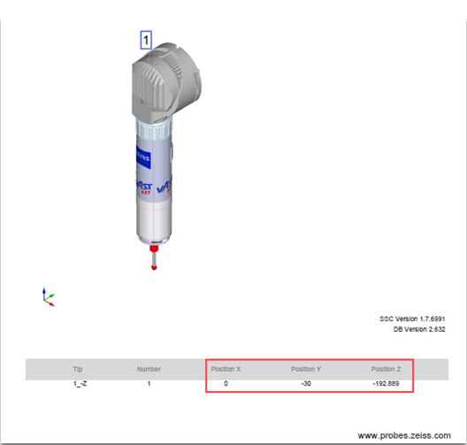

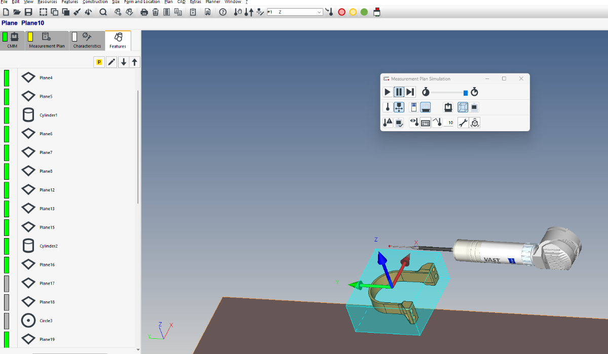

[Er...] Posted October 30, 2025 Share Posted October 30, 2025 During Plan simulation, the stylus system does not display the correct location when it rotates. A0B0 goes to the correct location. I followed the Zeiss offline setup instruction on the portal. Does anyone know how to resolve this issue? Link to comment https://qualityforum.zeiss.com/topic/24945-planner-stylus-rotation-not-synchronized/ Share on other sites More sharing options...

[Ky...] Posted October 30, 2025 Share Posted October 30, 2025 Is this a CAA stylus or fixed angle? If CAA, you need to qualify the MasterProbe and then do the fitting position. After that I would delete this probe and remake it. If this is fixed angle, then this document should help: https://portal.zeiss.com/knowledge-base?id=910456. I would delete everything but the down stylus and then walk through it. Hope that helps. Link to comment https://qualityforum.zeiss.com/topic/24945-planner-stylus-rotation-not-synchronized/#findComment-141203 Share on other sites More sharing options...
