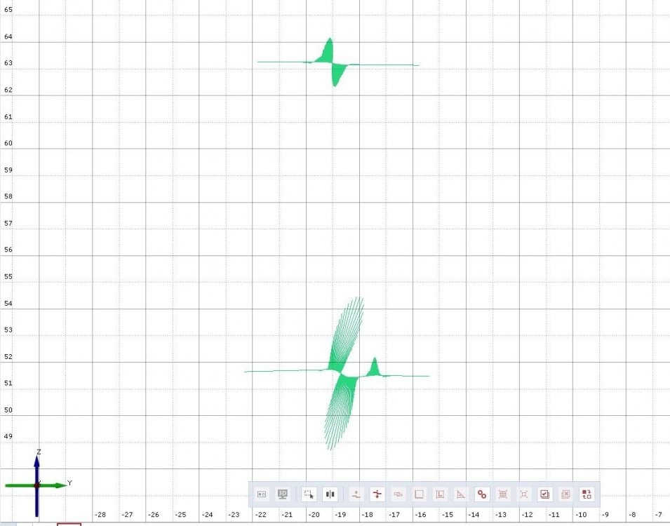

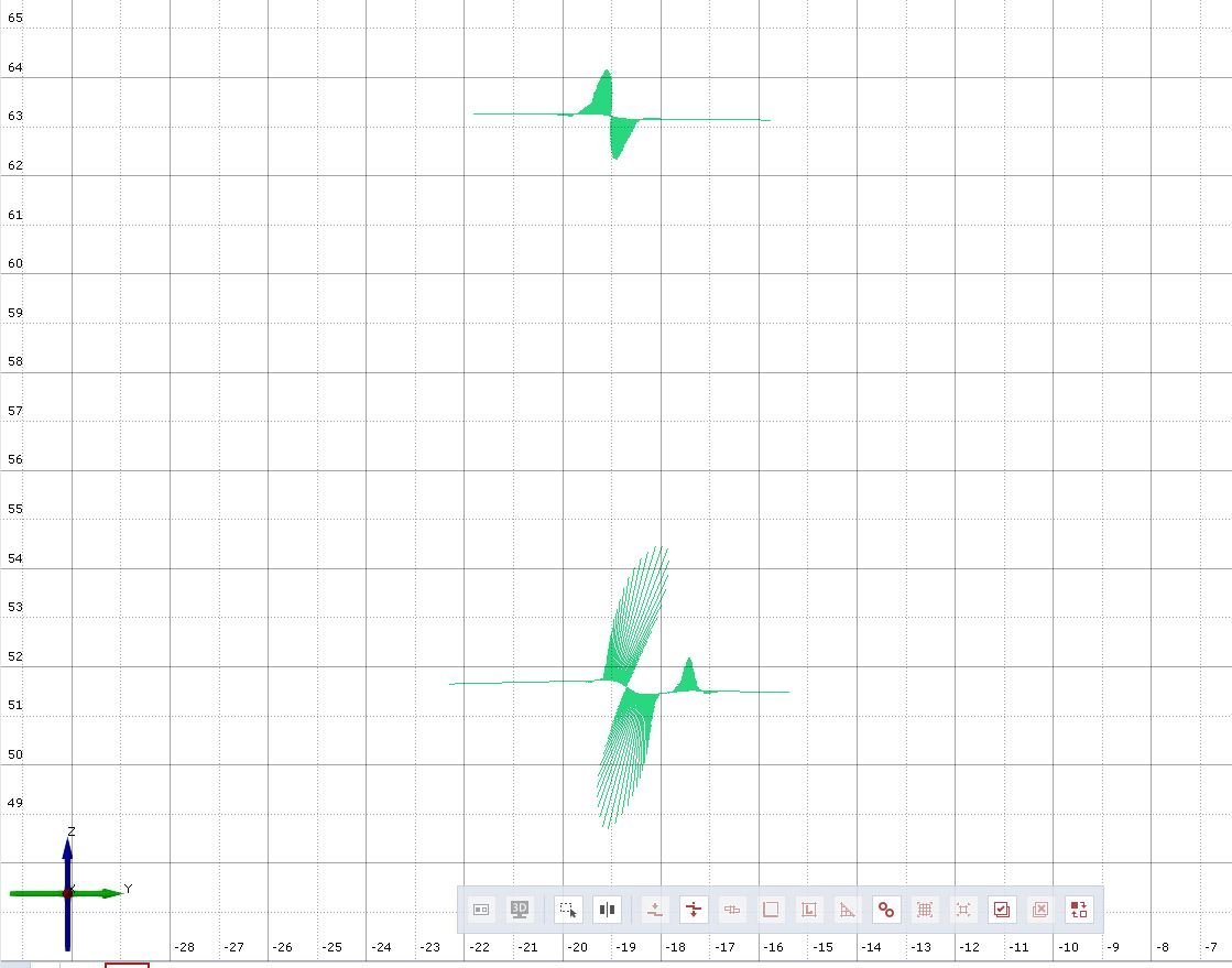

[Ma...] Posted November 3, 2025 Share Posted November 3, 2025 Hello everyone, I would like to ask whether it is possible to define the lowest and highest point on a curve in the direction of Z. I need these points for measuring the distance between given curves. Thanks for help, Matej Link to comment https://qualityforum.zeiss.com/topic/24965-highestlowest-point-in-direction-z/ Share on other sites More sharing options...
[Na...] Posted November 4, 2025 Share Posted November 4, 2025 Hi Matej, for the shortest distance between two curves there is this distance you can construct: https://techguide.zeiss.com/en/zeiss-inspect-2025/article/cmd_inspection_create_curve_curve_distance.html If you want to specify the highest point in a certain direction for example, you can create a touch point (disc) for example and chose the curve in the dialog for 'Project onto'. Then create a two point distance from the two touch points. Nanno Link to comment https://qualityforum.zeiss.com/topic/24965-highestlowest-point-in-direction-z/#findComment-141415 Share on other sites More sharing options...
