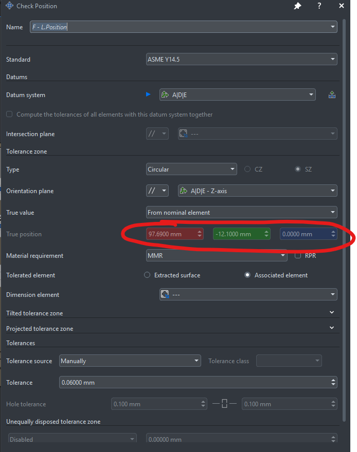

[JO...] Posted November 4, 2025 Share Posted November 4, 2025 Is there an easy way to include the basic dimensions and their actual measurements when checking positions? We are an injection molder and need these for tool adjustments. I supposed I could go create the elements needed and report them that way, but all the data is already here, can we simply choose to show it? Link to comment https://qualityforum.zeiss.com/topic/24999-including-basic-dimensions-in-results/ Share on other sites More sharing options...
[Ma...] Posted November 4, 2025 Share Posted November 4, 2025 Well you can do User defined check. Add additional input elements and add just this TP callout. Now in nominal you can write this: "A.tolerance_true_position_x" -> or under A -> Geometry 1 Link to comment https://qualityforum.zeiss.com/topic/24999-including-basic-dimensions-in-results/#findComment-141455 Share on other sites More sharing options...
