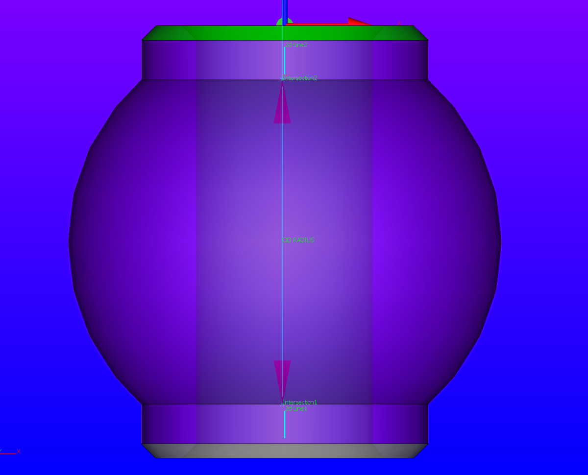

[Al...] Posted November 5, 2025 Share Posted November 5, 2025  I am trying to measure the sphere distance from intersection1 to intersection2. Does this measurement work? Any suggestions would be appreciated 🙂 1 Link to comment https://qualityforum.zeiss.com/topic/25017-measuring-a-sphere/ Share on other sites More sharing options...
[Ri...] Posted November 5, 2025 Share Posted November 5, 2025 Measure the sphere. Measure a cylinder at each end of the sphere. Create intersections for each cylinder/Sphere. Measure between both intersections. 1 1 Link to comment https://qualityforum.zeiss.com/topic/25017-measuring-a-sphere/#findComment-141521 Share on other sites More sharing options...
