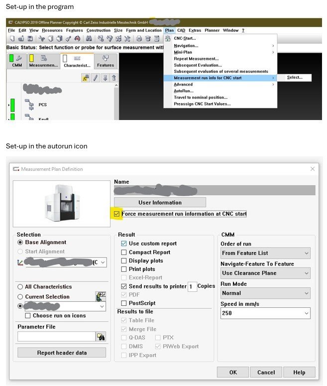

[To...] Posted November 6, 2025 Share Posted November 6, 2025 Is there a way to have the setup picture pop up when opening a program using PCM? Link to comment https://qualityforum.zeiss.com/topic/25023-pcm-command-to-show-setup-picture-upon-opening-program/ Share on other sites More sharing options...
[Ch...] Posted November 6, 2025 Share Posted November 6, 2025 Hi, There are 2 easier ways of doing this, 1) using plan > Measurement run info for CNC Start 2) using a 'programmable stop' inside of your first feature but if you want to use PCM : These should work : systemCallWithWait("cmd.exe /c start C:\path_to_your_set_up\setup.ppt") Also : // Assuming set up pic is in your program folder - probably the best place for it. DIR=getActualInspectionDir() systemCallWithWait("cmd.exe /c start "+DIR+"\set_up.ppt") 1 Link to comment https://qualityforum.zeiss.com/topic/25023-pcm-command-to-show-setup-picture-upon-opening-program/#findComment-141567 Share on other sites More sharing options...
[Ch...] Posted November 7, 2025 Share Posted November 7, 2025 Another easy way without using pcm is the "inspection_post_load.bat" method. inspection_post_load will run when you load the program. Just create a file with this name and place it in your program folder. To call a file all you have to do is put the file path inside the file. For example: "C:\Lab\Lab Documents\SampleFile.pdf" Be sure to include the quotation marks. 2 Link to comment https://qualityforum.zeiss.com/topic/25023-pcm-command-to-show-setup-picture-upon-opening-program/#findComment-141609 Share on other sites More sharing options...

[is...] Posted November 14, 2025 Share Posted November 14, 2025 Another way without pcm. 1 Link to comment https://qualityforum.zeiss.com/topic/25023-pcm-command-to-show-setup-picture-upon-opening-program/#findComment-141953 Share on other sites More sharing options...
