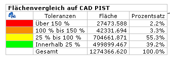

[Lu...] Posted November 12, 2025 Share Posted November 12, 2025 Hi there, In my report pages I have a label created using the Statistic template, which looks like the following: Is there a way to get access to the data of the table and export it? An alternative would be to export the image, if possible. Thank You very much, Lukas Link to comment https://qualityforum.zeiss.com/topic/25071-export-of-label-data/ Share on other sites More sharing options...
[Lu...] Posted November 18, 2025 Author Share Posted November 18, 2025 There is no direct way to access these values, but you can calculate the percentages in the right column by using the I-Inspect menu with Control+RMB and calculating (inspection.distance_statistics.portion_of_positive_pass+inspection.distance_statistics.portion_of_negative_pass) as explained in https://techguide.zeiss.com/en/zeiss-inspect-2025/article/how_to_display_statistical_results_of_a_surface_comparison_in_gom_software.html 1 Link to comment https://qualityforum.zeiss.com/topic/25071-export-of-label-data/#findComment-142159 Share on other sites More sharing options...
