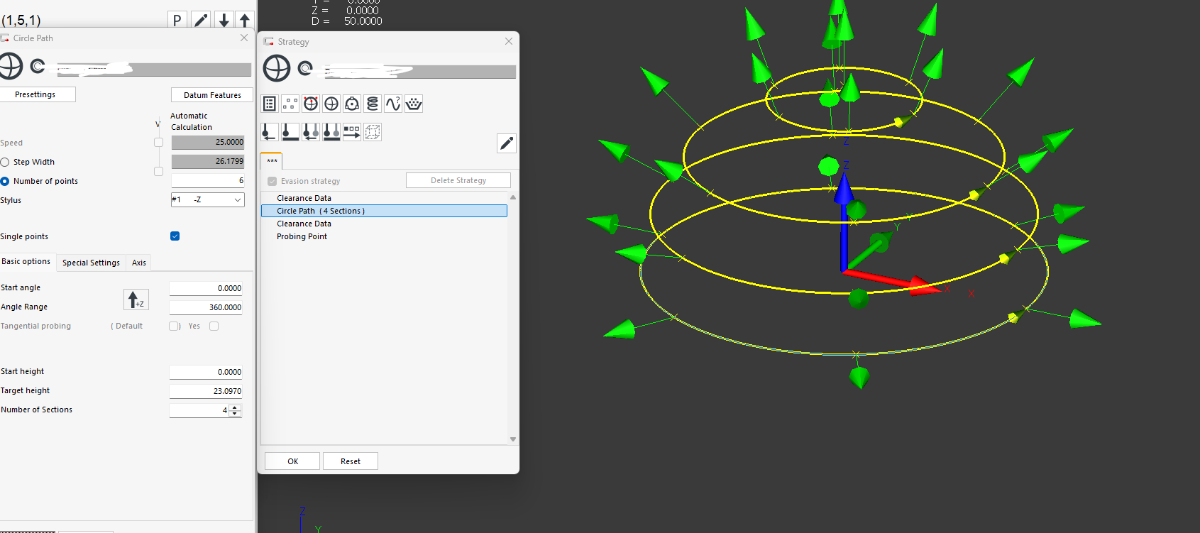

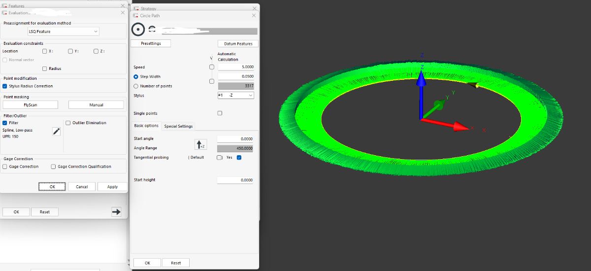

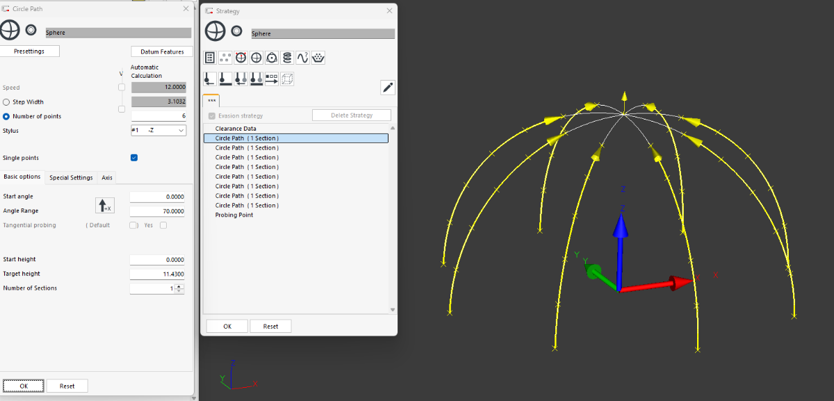

[Ri...] Posted November 17, 2025 Share Posted November 17, 2025 (edited) Do you really want Roundness if these are supposed to be precision spheres? Typically you would want to look at the entire form of the sphere. In the past when I've need to certify precision balls (say Grade 25 or better) I wouldn't scan it as the primary check. Here is an example of one that I've done before. (8) equally spaced running the direction of latitude with a single point at the north pole. Here is another example, in this example the lines run the direction of longitude. Here is an example of a 2" sphere that was requested to add the roundness at the equator. Edited November 17, 2025 Link to comment https://qualityforum.zeiss.com/topic/25073-scanning-spheres-multiple-sizes-for-roundness-of-00005/#findComment-142085 Share on other sites More sharing options...
[Ch...] Posted November 17, 2025 Share Posted November 17, 2025 Hello everyone, I would combine variants 1 and 2. I think that contains the most information and points. For a presentation/plot, you should then choose the circle that interests you most. Link to comment https://qualityforum.zeiss.com/topic/25073-scanning-spheres-multiple-sizes-for-roundness-of-00005/#findComment-142089 Share on other sites More sharing options...
[Ri...] Posted November 17, 2025 Author Share Posted November 17, 2025 I do use a similar scan to Richard Schomaker's first image to locate the sphere but no Center Point, the spheres have a diameter intersecting from .054-.125. and the lower portion is cut off by clearance cuts (No big deal here) so I get about 240° max scan at full center (The arc length will vary by part, it's all in PCM and Para). I forgot to note the finish is 6Ra or less. Also note, scanning a Ref Sphere with 0.20Mu, an MSA is in the <25% range for roundness (The sphere is Ø8mm). The 25% is high, I am not sure if the Micura can do this, it has an MPE of 0.9. Link to comment https://qualityforum.zeiss.com/topic/25073-scanning-spheres-multiple-sizes-for-roundness-of-00005/#findComment-142103 Share on other sites More sharing options...
[Ri...] Posted November 17, 2025 Share Posted November 17, 2025 You are correct. While the Micura is an extremely accurate CMM, extremely tight form tolerances would push you into the Prismo Ultra world with the Form Package. Please sign in to view this quote. 1 Link to comment https://qualityforum.zeiss.com/topic/25073-scanning-spheres-multiple-sizes-for-roundness-of-00005/#findComment-142107 Share on other sites More sharing options...
