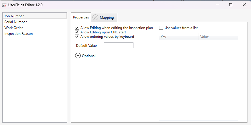

[Ch...] Posted November 14, 2025 Share Posted November 14, 2025 I need a reminder guys. I'm setting up my planner seat on a new computer(my old one fried) and forgot how to do something. I've copied my userfields.ini file into the new planner It's recognizing my user fields in Calypso but they are not transferring to PiWeb reports. I know it has something to do with mapping but I forgot how to get to that menu. Is there another file I need to copy over with the userfields.ini file? 1 Link to comment https://qualityforum.zeiss.com/topic/25101-userfieldsini-setting-up-new-machine-and-need-piweb-help/ Share on other sites More sharing options...
[Ra...] Posted November 14, 2025 Share Posted November 14, 2025 Is this the one you're after? Resources -> design custom report -> Editor for user defined report header variables. 1 Link to comment https://qualityforum.zeiss.com/topic/25101-userfieldsini-setting-up-new-machine-and-need-piweb-help/#findComment-141983 Share on other sites More sharing options...
[Ch...] Posted November 14, 2025 Author Share Posted November 14, 2025 Well crap, that was what I was thinking about but they are still not mapping to PiWeb. Luckily its not impacting my production machines. I'm going to have to re-learn about PiWeb Measurement Attributes Keys. Does anyone remember how I get these over to PiWeb? Link to comment https://qualityforum.zeiss.com/topic/25101-userfieldsini-setting-up-new-machine-and-need-piweb-help/#findComment-141991 Share on other sites More sharing options...
[Ri...] Posted November 14, 2025 Share Posted November 14, 2025 The userfields.ini contains the proper mapping inside of it. if they aren't showing up in your PiWeb report then they aren't linked in that PiWeb Report you are using would be my guess. Link to comment https://qualityforum.zeiss.com/topic/25101-userfieldsini-setting-up-new-machine-and-need-piweb-help/#findComment-141999 Share on other sites More sharing options...
[Ra...] Posted November 14, 2025 Share Posted November 14, 2025 Are your production CMMs using a modified standard protocol for output? You might just need to copy the template from the production CMMs to your planner seat. Link to comment https://qualityforum.zeiss.com/topic/25101-userfieldsini-setting-up-new-machine-and-need-piweb-help/#findComment-142011 Share on other sites More sharing options...
[Ch...] Posted November 15, 2025 Author Share Posted November 15, 2025 Please sign in to view this quote. Please sign in to view this username. That's what I thought, but numbers match between my PiWeb report and the mapping menu. I copied the userfields.ini and report templates from my production machines where they work just fine. I'm going to keep poking at it and just hope they start working. Link to comment https://qualityforum.zeiss.com/topic/25101-userfieldsini-setting-up-new-machine-and-need-piweb-help/#findComment-142027 Share on other sites More sharing options...
