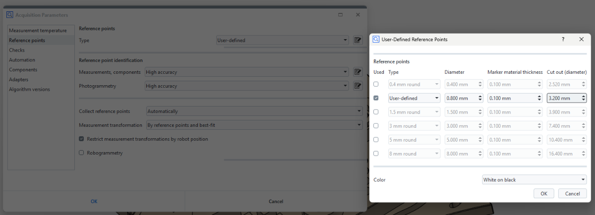

[Ma...] Posted November 18, 2025 Share Posted November 18, 2025 Hi, we've tried using ordinary table magnets ( cylinders ) with sticked original ( in other words correct ) refference points. Question: Can you define own sizes permanently? Or having it selected and setted by scanning template. I know you can use user defined, but we can not get rid of scanned "cylinder of a magnet". We thought by defining diameter and height it will cut this part of a scan. Otherwise i'll need to came with an APP to remove those remnants by using ref. point location and it's vector. Link to comment https://qualityforum.zeiss.com/topic/25139-custom-refference-points/ Share on other sites More sharing options...
[Na...] Posted November 19, 2025 Share Posted November 19, 2025 Hi Martin, it is possible in the acquisition parameters -> reference points. You have to switch to 'user defined' -> 'user defined' again to edit the cut out parameters: Link to comment https://qualityforum.zeiss.com/topic/25139-custom-refference-points/#findComment-142235 Share on other sites More sharing options...
[Ma...] Posted November 19, 2025 Author Share Posted November 19, 2025 Please sign in to view this username. Thanks, i was able to go this far, but can I define own name with data and store it to be able to just select it from list instead of redefining on new projects? I saw folder named "atos_ref_points_templates" in AppData/roaming/gom, but i don't know if there should be json or other file. Link to comment https://qualityforum.zeiss.com/topic/25139-custom-refference-points/#findComment-142243 Share on other sites More sharing options...
[Na...] Posted November 19, 2025 Share Posted November 19, 2025 I am not aware of a way to save them by name or add then to an app like with other custom templates. If you create a project template with the user defined reference points in the acquisition parameters it will be saved in the project template and the set acquisition parametesr will be used for scanning. The folder in Appdata seems to store reference point frames, which are located in the preferences -> templates in the software. 1 Link to comment https://qualityforum.zeiss.com/topic/25139-custom-refference-points/#findComment-142253 Share on other sites More sharing options...
