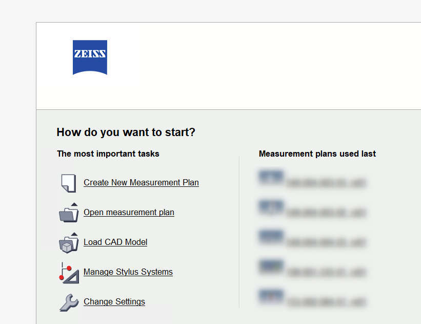

[Ch...] Posted November 19, 2025 Share Posted November 19, 2025 Hi everyone! Can I delete the list of recently opened test plans? Link to comment https://qualityforum.zeiss.com/topic/25143-list-of-measurement-plans-used-last/ Share on other sites More sharing options...
[Ma...] Posted November 19, 2025 Share Posted November 19, 2025 By manual editing of certain files yes - in Calypso - no. But why? Link to comment https://qualityforum.zeiss.com/topic/25143-list-of-measurement-plans-used-last/#findComment-142245 Share on other sites More sharing options...
[Ch...] Posted November 19, 2025 Author Share Posted November 19, 2025 (edited) I need to check a colleague's programs; he shouldn't see this. Edited November 19, 2025 Link to comment https://qualityforum.zeiss.com/topic/25143-list-of-measurement-plans-used-last/#findComment-142249 Share on other sites More sharing options...
[Ma...] Posted November 19, 2025 Share Posted November 19, 2025 If you use own login, then you have your own list of recent. Unfortunatelly i can not tell you right now which file it is and where it is, but it should be one where are users stored 1 Link to comment https://qualityforum.zeiss.com/topic/25143-list-of-measurement-plans-used-last/#findComment-142251 Share on other sites More sharing options...
[DW...] Posted November 19, 2025 Share Posted November 19, 2025 Please sign in to view this username. Couldn't you just open five random programs after you are finished looking at his programs to repopulate the 'most recent' list? Link to comment https://qualityforum.zeiss.com/topic/25143-list-of-measurement-plans-used-last/#findComment-142271 Share on other sites More sharing options...
[Ma...] Posted November 19, 2025 Share Posted November 19, 2025 Found that file. If you want to hide that, then you can do this. relogin go to "c:\ProgramData\Zeiss\CALYPSO x.x\users\YOUR_USER\config\env\" and make copy of file "values" do your actions logout restore original file from copy But DWC advise is good too and surelly working. Mine is not tested. 1 Link to comment https://qualityforum.zeiss.com/topic/25143-list-of-measurement-plans-used-last/#findComment-142297 Share on other sites More sharing options...
[Ch...] Posted November 20, 2025 Author Share Posted November 20, 2025 🤘🏻 thank you guys , Please sign in to view this username. ´that was my first solution, but it is work 🤣 Please sign in to view this username. I try your first solution, because its easy and fast 👍🏻 THX nice working day. Link to comment https://qualityforum.zeiss.com/topic/25143-list-of-measurement-plans-used-last/#findComment-142331 Share on other sites More sharing options...
[No...] Posted November 20, 2025 Share Posted November 20, 2025 Please sign in to view this quote. This should work as long as you don't reconfigure anything else user-related before restoring the old file, because such changes would be revoked when the old file is put back. Link to comment https://qualityforum.zeiss.com/topic/25143-list-of-measurement-plans-used-last/#findComment-142333 Share on other sites More sharing options...
[Ri...] Posted November 20, 2025 Share Posted November 20, 2025 After opening the CMM program and you are completely done with it, remove it from the folder. Presto, it's not in the list anymore. Link to comment https://qualityforum.zeiss.com/topic/25143-list-of-measurement-plans-used-last/#findComment-142355 Share on other sites More sharing options...
