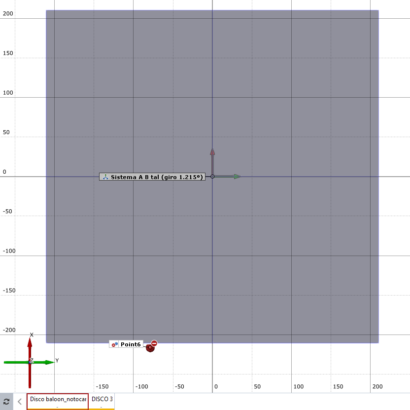

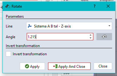

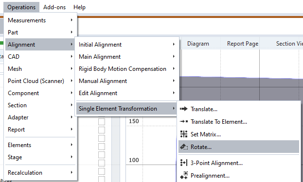

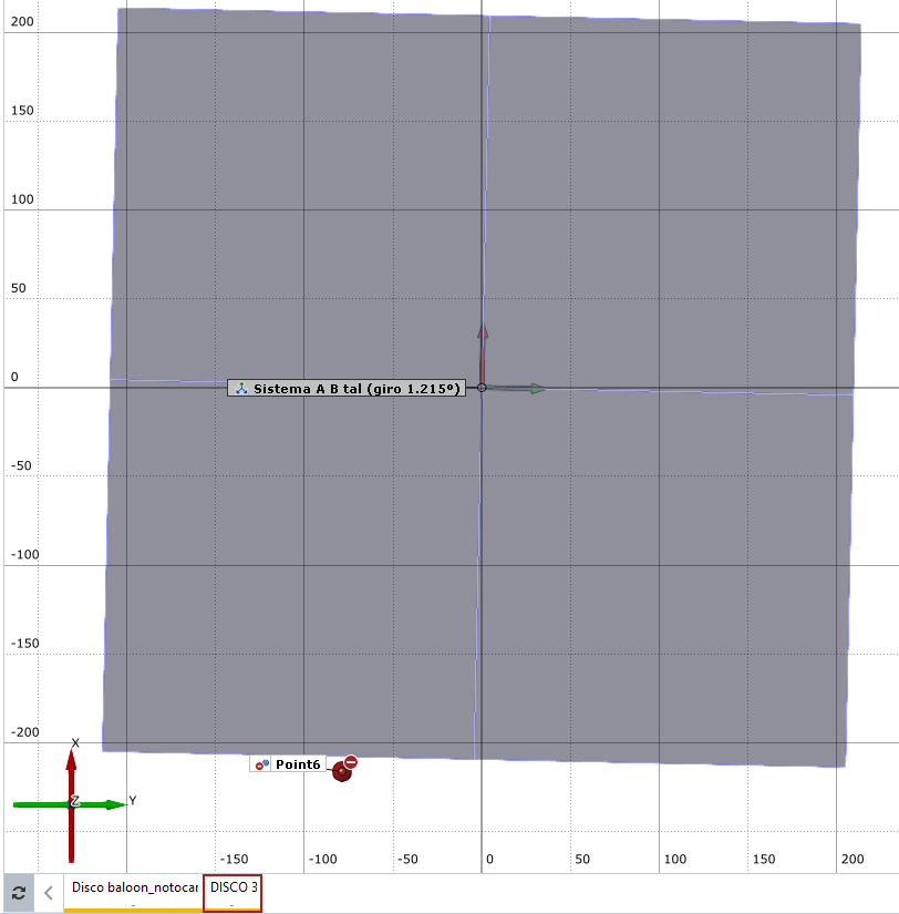

[Ir...] Posted November 19, 2025 Share Posted November 19, 2025 I used the 'Single Element Transformation' command to rotate a coordinate system. However, this change was only applied to the stage I was working on, not to the others. When I perform the same action on a point, it updates across all stages. The command I used is as follows: In the next image, you can see the coordinate system and the point in the same stage where I rotated them: In contrast, in the other stage, the system has not been rotated: Why does this happen? Link to comment https://qualityforum.zeiss.com/topic/25145-single-element-transformation-rotate-for-a-datum-system-in-different-stages/ Share on other sites More sharing options...
[DW...] Posted November 21, 2025 Share Posted November 21, 2025 Please sign in to view this username. I really only use the single element transformation to rotate the CAD or parts to my blueprint drawing view for easy programming. Perhaps you would be better suited to make a coordinate system and rotate the coordinate system to the desired position. Then use this alignment for your evaluation. Link to comment https://qualityforum.zeiss.com/topic/25145-single-element-transformation-rotate-for-a-datum-system-in-different-stages/#findComment-142475 Share on other sites More sharing options...
