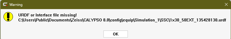

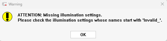

[Co...] Posted November 20, 2025 Share Posted November 20, 2025 Hi all! I just installed Calypso 2025 I am having issues setting up my offline seat. I wanted to check to see if anyone might have suggestions/solutions for some of these problems. I can open the software and it looks like all my licenses are finally working. CAD Models load fine - but when I turn on Measurement Plan Simulation, I immediately get the URDF/Interface File Missing Warning and it won't run with any visual probe on the screen. I also get this Missing Illumination Settings message every time I startup Calypso. Just wanted to see if anyone might have an idea of how to fix this! Thanks! 1 Link to comment Share on other sites More sharing options...
[Ch...] Posted March 11 Share Posted March 11 I, too, am seeing this message displayed when opening various measurement programs. It began a month or two ago after upgrading to Calypso 2025 - any ideas how to 'fix' this? Link to comment Share on other sites More sharing options...
[Co...] Posted April 3 Author Share Posted April 3 Please sign in to view this username. I still don't have a resolution to this and just noticed you replied so I see it isn't just me. I just opened a ticket with Zeiss this morning to see if they might have any idea why or how to resolve this. I will update here if I get anything back from them. Thanks for letting me know you had the same problem! 1 Link to comment Share on other sites More sharing options...
[Ch...] Posted April 16 Share Posted April 16 I'm pretty sure Cory did a complete uninstall and re-install of Calypso 2025 with the latest patch "8.0.1203" then created a new master probe + imported other probes and that seems to work in simulation. Link to comment Share on other sites More sharing options...
