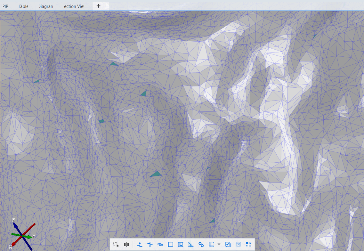

[Br...] Posted November 21, 2025 Share Posted November 21, 2025 Hello, I am noticing a difference in the mesh appearance when I upload it after a pre-trimming operation (in Meshmixer). It shows some green triangles whether it is set as CAD or as a mesh. In the CAD view, it also displays the same red edges when I activate the boundary lines. Could someone shed some light on what this represents? Is it a defect inherent to exporting after editing in another software? Is there a correction procedure I should apply in these cases? If so, could it modify the surface? My goal is to compare how one mesh is distorted relative to another, so I am concerned that applying such procedures might affect the results. Link to comment https://qualityforum.zeiss.com/topic/25181-green-triangles-on-pre-edited-meshes/ Share on other sites More sharing options...

[Br...] Posted November 23, 2025 Author Share Posted November 23, 2025 (edited) Hi Nanno, Thank you so much for your reply and link provided. It follows an example. They are not shown if I upload the raw file, without pre-trimming. They also remain showing after applying the 3D comparison. Could it fall into Fanfolded triangles category? I tried to repair it however it encompassed a large area, more that I would like to modify. Edited November 23, 2025 Link to comment https://qualityforum.zeiss.com/topic/25181-green-triangles-on-pre-edited-meshes/#findComment-142511 Share on other sites More sharing options...
[Ma...] Posted November 24, 2025 Share Posted November 24, 2025 For me it looks like either hole ( missing triangle ) or inverted face of that triangle. Link to comment https://qualityforum.zeiss.com/topic/25181-green-triangles-on-pre-edited-meshes/#findComment-142539 Share on other sites More sharing options...
[Na...] Posted November 24, 2025 Share Posted November 24, 2025 They look like inverted (standard color of mesh rear side). It should be possible to fixed with this function: ZEISS Quality Tech Guide Link to comment https://qualityforum.zeiss.com/topic/25181-green-triangles-on-pre-edited-meshes/#findComment-142541 Share on other sites More sharing options...
[Br...] Posted November 24, 2025 Author Share Posted November 24, 2025 Hi Martin and Nanno, I am truly grateful for your help in clarifying what those triangles were and for the very useful link you, Nanno, provided. Since my mesh had many small green (inverted) triangles, I found this tool in the same context of the link above, which was extremely helpful for orienting all of them at once. https://techguide.zeiss.com/en/zeiss-inspect-2025/article/cmd_mesh_automatically_orient_selected_normals.html Once again, thank you both very much Link to comment https://qualityforum.zeiss.com/topic/25181-green-triangles-on-pre-edited-meshes/#findComment-142565 Share on other sites More sharing options...
