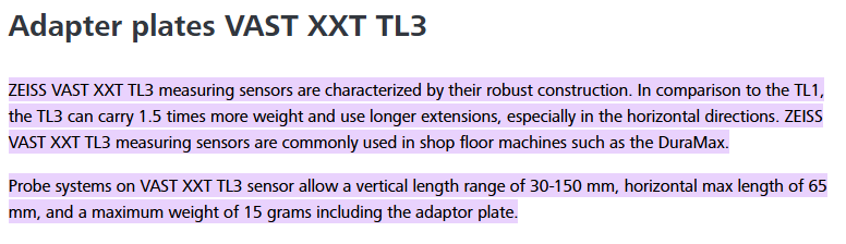

[Br...] Posted November 25, 2025 Share Posted November 25, 2025 How long or heavy of a probe can a RDS probe head handle? Link to comment https://qualityforum.zeiss.com/topic/25199-rds-xxt-tl3-probe-size-legth-capabilities/ Share on other sites More sharing options...
[Du...] Posted November 25, 2025 Share Posted November 25, 2025 Link to comment https://qualityforum.zeiss.com/topic/25199-rds-xxt-tl3-probe-size-legth-capabilities/#findComment-142605 Share on other sites More sharing options...
