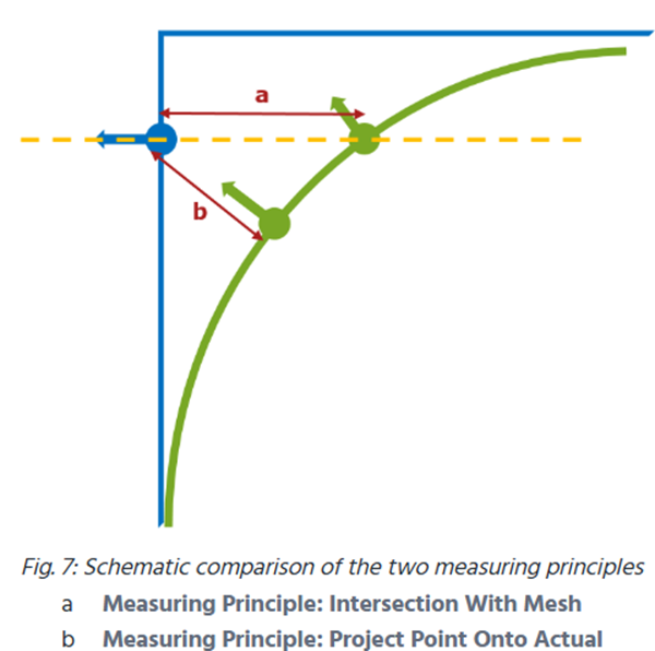

I've read the TecGuide and I'm aware of the differences, but I've never used the projection point Onto actual before.
What are the application examples for the projection point measurement principle? Does anyone perhaps have some technically correct examples for me?image.png.34d22528f5c6b98d3e9f7efa1f186082.png
You will get another reading when used intersection or projection.
Intersection: you will get point from mesh for given nominal point in direction of nominal point vector.
Projection: you will get point from mesh for given nominal point in direction of measured point vector.
This image is describing well what you get, but actual usage will be determined mainly by measured element.
You will get more correct results on plane with intersection, then projecting i think and i think it's mostly used.
But i am still learning

One situation where I sometimes use projection instead of intersection is when I have to measure in regions of the part where I expect small holes to appear due to limited coverage of the part surface. It's very annyoing having to edit many point measurements just because the elongated nominal vector hits a tiny hole in the mesh and you get no result. By using projection instead I can often get a result right next to the hole anyway.  Of course it depends a lot on the circumstances and the purpose of the measurement.
