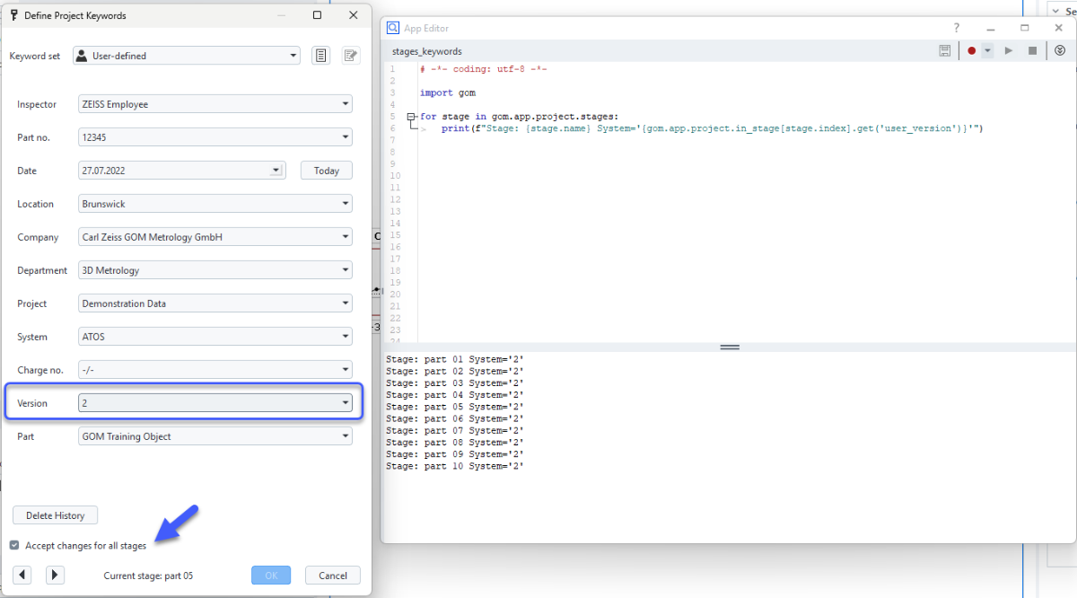

[Jo...] Posted December 2, 2025 Share Posted December 2, 2025 Hello All, In a project a keyword became unwanted stage specific. How can I change this and make this keyword behave as a none stage specific? I tried deleting and recreating, but this was not successful. It kept stage specific. Also tried it with the python interface. What can I do? Is there a work around? The keyword is used in table and label templates. Thanks in advance. Johnny Link to comment https://qualityforum.zeiss.com/topic/25247-element-keywords-change-from-stage-specific-to-normal/ Share on other sites More sharing options...
[Na...] Posted December 11, 2025 Share Posted December 11, 2025 Hell Johnny, I just tried with 2026 and a stage specific keyword could be changed by ticking the box in the dialog 'Accept changes for all stages', changing the keyword -> OK. I checked by using the arrows in the dialog and with the code from the App Development documentation # -*- coding: utf-8 -*- import gom for stage in gom.app.project.stages: print(f"Stage: {stage.name} System='{gom.app.project.in_stage[stage.index].get('user_version')}'") Which version are you using? Link to comment https://qualityforum.zeiss.com/topic/25247-element-keywords-change-from-stage-specific-to-normal/#findComment-143397 Share on other sites More sharing options...

[Na...] Posted December 11, 2025 Share Posted December 11, 2025 Hi, it prints the keywords for every stage, so if the checkbox is on, the keyword should be the same for all stages -> Keyword is not stage specific. It also worked in 2025 for me: OK was clicked like in the screenshot, the result after that is on the right for every stage. Link to comment https://qualityforum.zeiss.com/topic/25247-element-keywords-change-from-stage-specific-to-normal/#findComment-143417 Share on other sites More sharing options...
[Jo...] Posted December 11, 2025 Author Share Posted December 11, 2025 Hello Nanno, This is not about the project keyword, but the element keyword. Johnny Link to comment https://qualityforum.zeiss.com/topic/25247-element-keywords-change-from-stage-specific-to-normal/#findComment-143431 Share on other sites More sharing options...
[Na...] Posted December 12, 2025 Share Posted December 12, 2025 Hi Johnny, looks like I misunderstood. We are analysing this in a support ticket right now. 1 Link to comment https://qualityforum.zeiss.com/topic/25247-element-keywords-change-from-stage-specific-to-normal/#findComment-143539 Share on other sites More sharing options...
