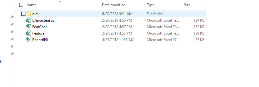

After upgrading to the latest version of Calypso, when I use the excel report it doesn't supply the actuals. Does anyone know the fix to this.  There are only a few parts/programs that I use the excel report so that I can put all the excel files put into one excel file so it's easier for the engineer that needs to review the data. I have the Zeiss macro that parts excel files into one excel file in landscape format. It formats it as it should but no data/results.
I attached the excel file for one of the parts ran today......nothing in the actuals column.

Hey Lincoln,
We've found some strange behavior with the Excel report that I believe we have narrowed down to reportini.xlsx (or reportINI.xls, depending on what excel template type you are using). If you are familiar with the file paths involved, you can bring those from the data/excel report folder in the older version into the same location in the newer, non-working version. Otherwise, if you have an SMA, it might be easier to call support honestly.

I'll have to check but I believe its all-old files.  The "excel_report" files that are all dated 2/20/2013 and the ReportINI dated 4/26/2012.
They should be at the same file path. We just upgraded in early September, and I backed up all that stuff as you should.  Dropped the old stuff where it should go.
The report has all nominals and tolerances, just no actuals.
Maybe I will contact Zeiss and see what they say.
Lincoln

I have seen this issue a few times from other customers.
As Kyle mentioned above it is typically due to the ReportINI file being outdated. You will either want to point to the new Excel directory for the excel templates:
"C:\Users\Public\Documents\Zeiss\CALYPSO 8.0\data\excel_report"
Or copy the ReportINI files from the new directory into your old directory where the current templates are being used.
