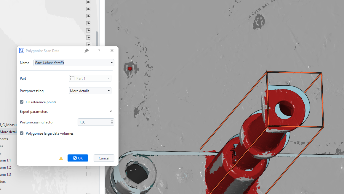

[Re...] Posted December 4, 2025 Share Posted December 4, 2025 Hi all, I was wondering if somebody could help me with the following problem: I made a scan template in Zeiss where 10 items are placed in a fixture. Mesh quality is very good but when i polygonize the mesh data the software draws a small orange box around the CAD's and if the mesh doesn't properly fit in this box it cuts away the mesh. My question is if I can increase the box size of remove it so my mesh won't be cut away. Kind Regards Link to comment https://qualityforum.zeiss.com/topic/25275-mesh-of-objects-multiscan-cut-away-by-polygonization/ Share on other sites More sharing options...
[Na...] Posted December 5, 2025 Share Posted December 5, 2025 Hi Rens, when this dialog is open, you can use selection tools (like 'through surface', 'inside cube') to edit the selection for the polygonization. This is saved when you press OK. The orange polygonization cubes can also be changed in size by script like in the attached addon/app. Polygonisierungsquader vergrößern.addon Link to comment https://qualityforum.zeiss.com/topic/25275-mesh-of-objects-multiscan-cut-away-by-polygonization/#findComment-143097 Share on other sites More sharing options...
[DJ...] Posted July 20 Share Posted July 20 Please sign in to view this quote. Good morning Nanno, I seem to be having a similar issue where it seems the orange boundary box for the CAD is cutting out the majority of my mesh. Is the script the only way to fix this or is there a native setting within Optical 3D 2026 pro that can be changed? Kind Regards, -Yager Link to comment https://qualityforum.zeiss.com/topic/25275-mesh-of-objects-multiscan-cut-away-by-polygonization/#findComment-153117 Share on other sites More sharing options...
[Na...] Posted July 30 Share Posted July 30 Hi DJ Yager, you can edit the creation parameters of the actual parts and select measuring data to polygonize with 'select inside cube' or other selection tools. Nanno Link to comment https://qualityforum.zeiss.com/topic/25275-mesh-of-objects-multiscan-cut-away-by-polygonization/#findComment-153722 Share on other sites More sharing options...
