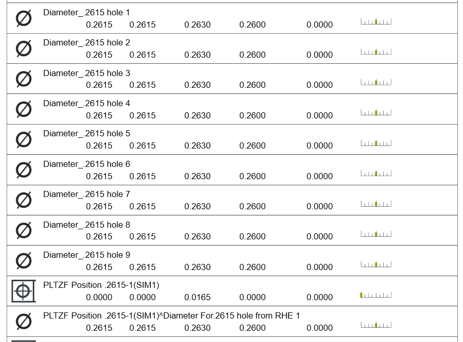

[Pa...] Posted December 6, 2025 Share Posted December 6, 2025 I've just started working with Calypso 2024. Using the GD&T position with MMC invoked, my report now shows the size of every hole used to calculate the bonus tolerance. I'd like to remove this from the report, as the same hole sizes show up once in the PLTZF, once in the FLTZF, and once where I just called for the diameter. My part has 100 holes so eliminating these redundancies will remove 200 lines from the report. I'm just poking around now to see if I can find a setting somewhere but any help would be appreciated. Link to comment https://qualityforum.zeiss.com/topic/25297-gdt-engine-mmc/ Share on other sites More sharing options...

[Sh...] Posted December 17, 2025 Share Posted December 17, 2025 All, I put in a ticket with Zeiss and we figured out a solution for this issue. If any of you are familiar with hiding the ".M, .L" characteristics mentioned on Knowledgebase - https://portal.zeiss.com/knowledge-base?id=458620 , the solution is an addition to that code in PiWeb. For my specific case I wanted to hide the diameters for GDT Position for MMR/LMR and to do that we used the code: {^((?!\.\(M|L\)|\^Diameter For).)*$} If there is anything else that you particularly want to hide, I suggest being very specific in that code about the characteristic name so that you don't accidentally hide something important. 1 Link to comment https://qualityforum.zeiss.com/topic/25297-gdt-engine-mmc/#findComment-143807 Share on other sites More sharing options...

[Pa...] Posted March 22 Author Share Posted March 22 I finally got around to trying Shawn's fix. It worked exactly as suggested. PiWeb designer is obtuse and terrible. I love the statement from the cited KB article: "highlight the relevant table". Clear as mud. I figured it out. For reference, the code in Shawn's suggestion will hide the (M) line, the (L) line, and these additional diameters. Those of us already hiding (M) and (L) lines will overwrite that existing code with this. Link to comment https://qualityforum.zeiss.com/topic/25297-gdt-engine-mmc/#findComment-148103 Share on other sites More sharing options...
