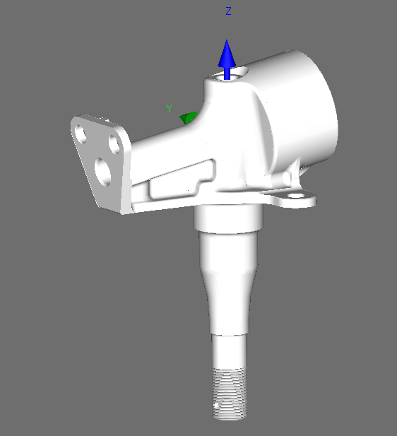

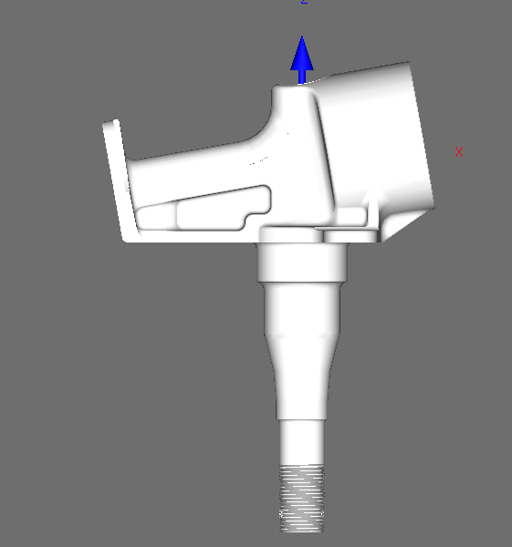

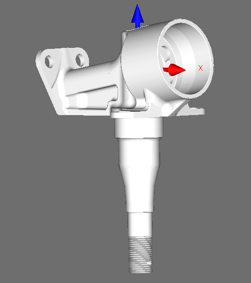

[Da...] Posted December 11, 2025 Share Posted December 11, 2025 Can someone give me an idea of how to fixture and base align this part? I am used to doing parts with flat planes perpendicular to each other that I can use for the alignment, but this part does not have that. I was thinking I would lift the part on standoffs although I am not sure how I will square it up or keep it from spinning (side note, if anyone has a recommendation for fixturing items that you find versatile or game-changing, feel free to pass those along!) Then I was thinking I would combine the tops of the two "wings" into a single plane and use that as Z origin. But as far as X and Y origins, there are not any planes perpendicular to those that I could use. I thought about making a plane on the back side of the tail and another on the top ledge of the tail and creating an intersection line and using that as the X origin, but I that still leaves Y and clocking. I am just completely stuck right now, so any input you have will probably generate a bunch of follow up questions from me, but I would appreciate any direction you can give. Link to comment https://qualityforum.zeiss.com/topic/25355-base-alignment-on-irregular-shaped-parts/ Share on other sites More sharing options...

[Ze...] Posted December 11, 2025 Share Posted December 11, 2025 I would create my Base Alignment on the side plane with the 3 holes in it, using the plane as spatial/origin (3 DOF), the 2 holes for clocking/ vertical origin (2 DOF). and the symmetry of the 2 holes as the horizontal origin(1 DOF) to center to the part/model. From there you can start to establish other alignments/features to meet your print requirements and/or create more robust alignments that consider datums, etc. 1 Link to comment https://qualityforum.zeiss.com/topic/25355-base-alignment-on-irregular-shaped-parts/#findComment-143465 Share on other sites More sharing options...
[Da...] Posted December 11, 2025 Author Share Posted December 11, 2025 Please sign in to view this quote. Would I need to do anything special to account for the fact that the side plane would not be perpendicular to the table? Link to comment https://qualityforum.zeiss.com/topic/25355-base-alignment-on-irregular-shaped-parts/#findComment-143503 Share on other sites More sharing options...
