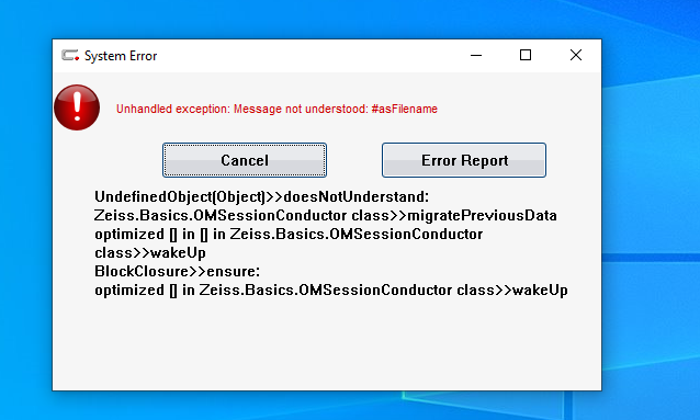

[Da...] Posted December 16, 2025 Share Posted December 16, 2025 Hi all, I installed offline Calypso 2019 on my PC and it fu*k up my Calypso 2014. I have deleted everything, every Zeiss folder and re-install Calypso 2014 from scratch a few times already but it's not working. Every time I tried to open it comes with that error message. Any help ideas please ? Link to comment https://qualityforum.zeiss.com/topic/25399-calypso-would-not-open/ Share on other sites More sharing options...
[Ri...] Posted December 16, 2025 Share Posted December 16, 2025 I am attaching a couple files with instructions and a registry stuff. I am not saying do what I do, this may be contingent to my situation. But you may be able to use information to help you resolve your problem. I wrote and have used the instructions where I currently work about 4 times now, each time I was successful at fixing all the problems from dual or multi installs. SQL SDCO Registry repair after a failed installation of a newer version of SQL SDCO.zip 1 Link to comment https://qualityforum.zeiss.com/topic/25399-calypso-would-not-open/#findComment-143733 Share on other sites More sharing options...
[Da...] Posted December 18, 2025 Author Share Posted December 18, 2025 Unfortunately this solution isn't working, any other ideas ? Link to comment https://qualityforum.zeiss.com/topic/25399-calypso-would-not-open/#findComment-143837 Share on other sites More sharing options...
[Ky...] Posted December 18, 2025 Share Posted December 18, 2025 It's going to be difficult to help much with 2014, but I might try a new config folder, just to see if that is the cause. It has been a very long time since I worked with 2014, so I don't remember exactly where the config folder is, but you can try using this document: https://portal.zeiss.com/knowledge-base?id=442607 Link to comment https://qualityforum.zeiss.com/topic/25399-calypso-would-not-open/#findComment-143879 Share on other sites More sharing options...
