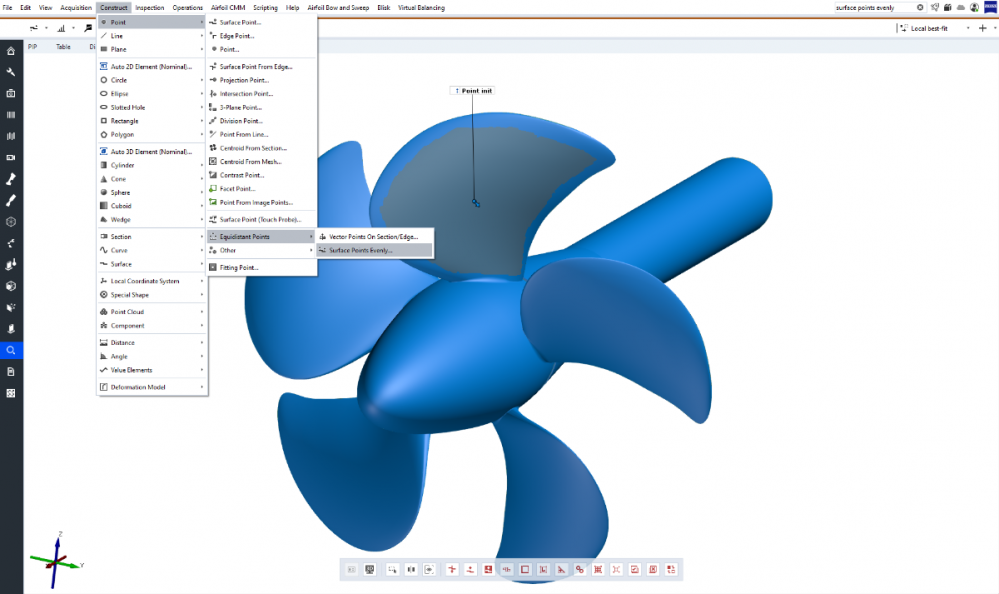

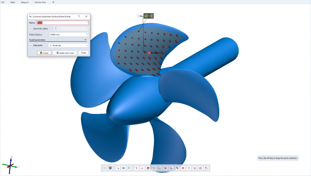

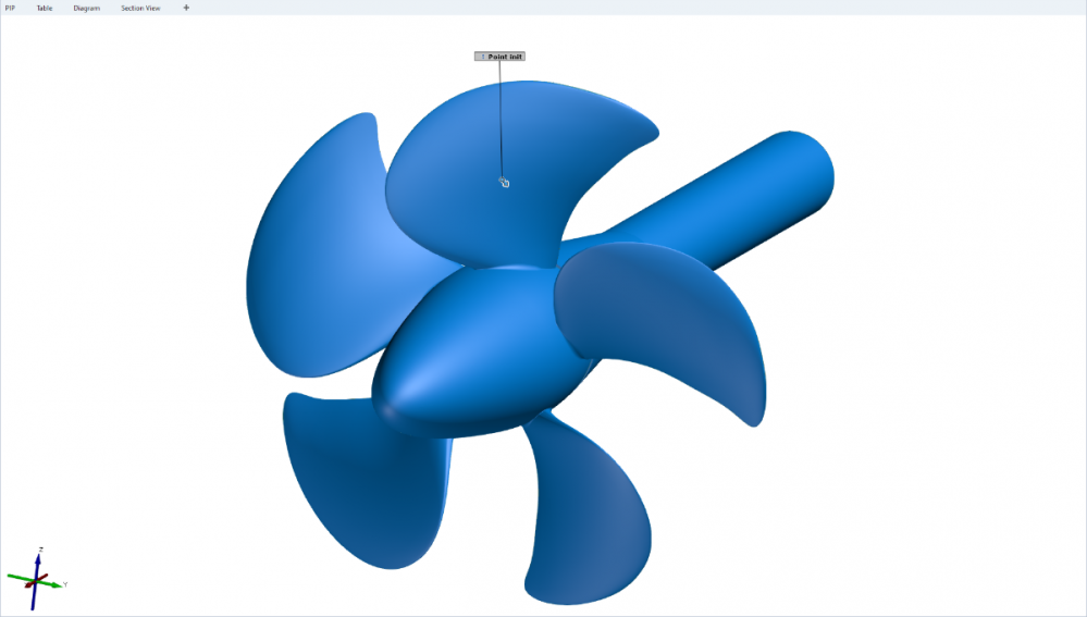

[Je...] Posted September 5, 2023 Share Posted September 5, 2023 Hey both, I know the question is mainly about scripting. And Peter, I noticed your post only now. But I would like to understand in the first attempt why the built-in function does not give the desired results for such purposes. Because the following procedure produces a uniform point pattern even on curved surfaces, as can be seen well on the ship's propeller: 1) A initial point on the area of interest 2) Selection of the area of interest and call of the function 3) Set the pattern input as needed As you can see, the points are created only in the selected area. This makes it possible to deal with special scenarios quite nicely. Also, the initial starting point does not have to be centrally located in the selected area. As I said, the point pattern is formed following the selected area. I hope this helps in the first step, if not then please come back to me - Jens Link to comment https://qualityforum.zeiss.com/topic/2542-surface-points-with-scripting-what-is-id_type_u-and-id_type_v/#findComment-8704 Share on other sites More sharing options...
