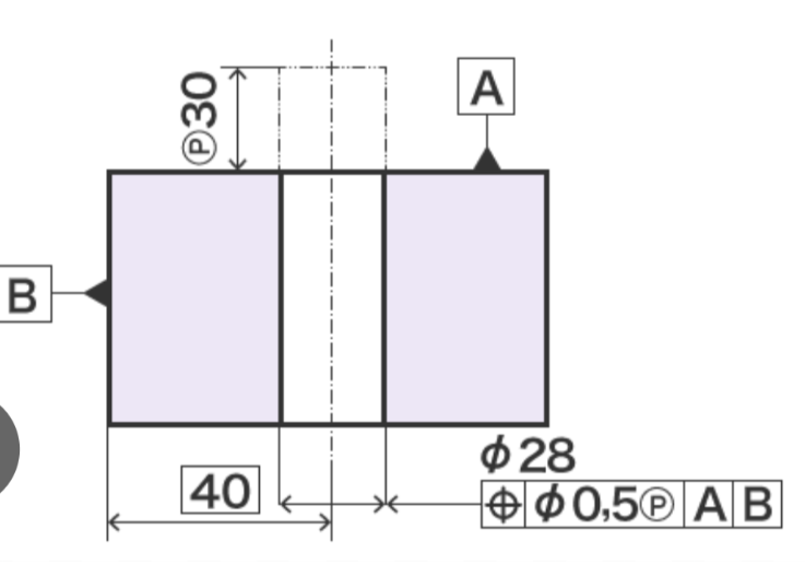

[Re...] Posted December 22, 2025 Share Posted December 22, 2025 Hallo Zusammen, wenn das P im Bezugsrahmen angeben ist. Wo kann ich in Zeiss inspect dann die projizierte Toleranzzone angegeben. Siehe Beispiel-Zeichnung Danke Link to comment https://qualityforum.zeiss.com/topic/25433-eingabe-und-auswertung-projizierte-toleranzzone-p/ Share on other sites More sharing options...

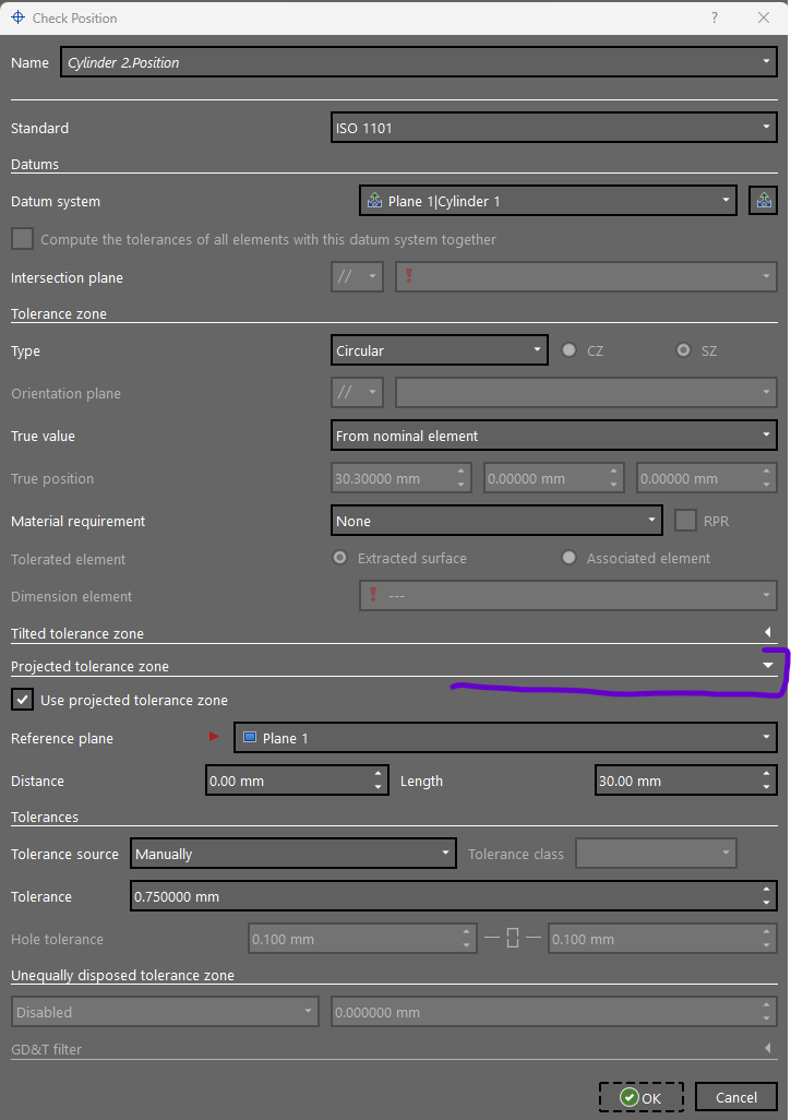

[na...] Posted December 22, 2025 Share Posted December 22, 2025 Please sign in to view this quote. Tick the triangle inside Position: 1 Link to comment https://qualityforum.zeiss.com/topic/25433-eingabe-und-auswertung-projizierte-toleranzzone-p/#findComment-143945 Share on other sites More sharing options...
