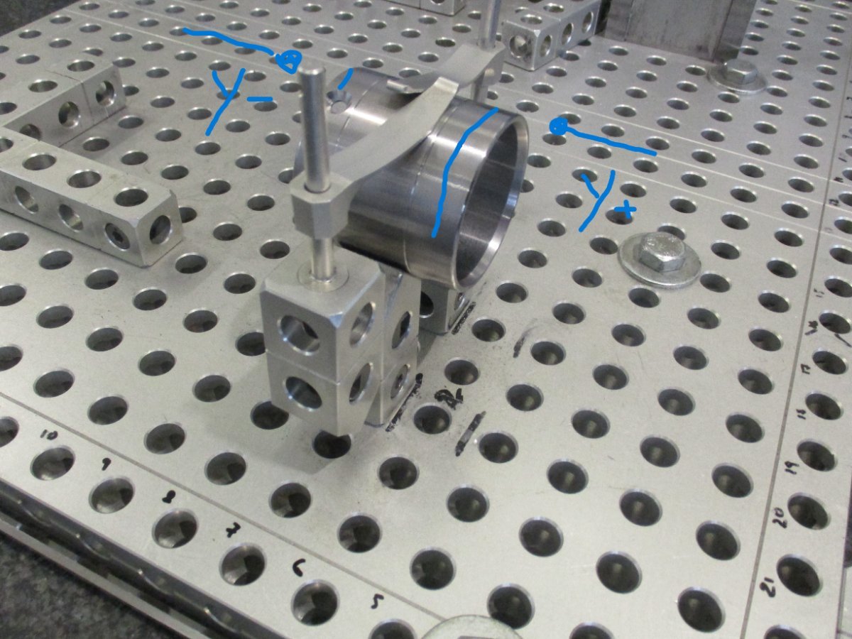

[Fe...] Posted January 7 Share Posted January 7 Good morning, how can I acquire the cylinder element using a double probe Y+; Y− as a single element, without colliding with the clamping fixture and without creating a 3D line? Thank you. Link to comment https://qualityforum.zeiss.com/topic/25485-cylinder-element-acquisition/ Share on other sites More sharing options...
[Ch...] Posted January 12 Share Posted January 12 (edited) Ciao Frederico, Can you understand this? To increase safety, you can add some intermediate positions to the part. Edited January 12 1 Link to comment https://qualityforum.zeiss.com/topic/25485-cylinder-element-acquisition/#findComment-144441 Share on other sites More sharing options...
[Je...] Posted January 12 Share Posted January 12 Hi Please sign in to view this username. Please sign in to view this username. 's strategy should work well. One other method is to create two cylinder or circle features, one for the Y- portion and the other for the Y+ portion. Then, create a third cylinder and use the "recall feature points" option. Choose the first two, measured cylinders or circles. This method emphasizes distinction between probes and clearance planes. Other strategies exist, as well. Keep us posted on how this turns out for you. 2 Link to comment https://qualityforum.zeiss.com/topic/25485-cylinder-element-acquisition/#findComment-144459 Share on other sites More sharing options...

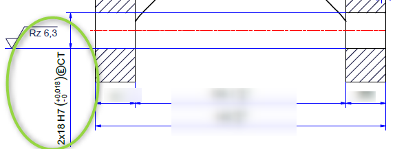

[Ch...] Posted January 13 Share Posted January 13 Please sign in to view this username. Thank you for your strategy, I can use it for myself: Because the distance between the two cylinder (>160 mm) is very large. 1 Link to comment https://qualityforum.zeiss.com/topic/25485-cylinder-element-acquisition/#findComment-144499 Share on other sites More sharing options...
