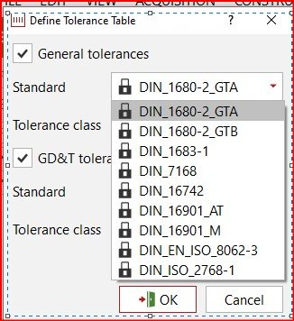

[Ma...] Posted June 8, 2021 Share Posted June 8, 2021 Hello readers Is it possible to buy other tolerance tables from GOM. Now standards other than those already included in the software have to be purchased and entered manually by creating new tables. Link to comment https://qualityforum.zeiss.com/topic/255-tolerance-tables-in-gom-inspect/ Share on other sites More sharing options...
[Ch...] Posted June 9, 2021 Share Posted June 9, 2021 Hi, buying other tolerance tables directly from GOM is not possible. But of course we like to hear which standards you are missing. So please left a short note (or contact your local GOM partner if you prefer a private discussion) about the standards that you are missing. We will create a feature request afterwards and discuss if we can introducing these standards in a future software version. Best regards Christoph Schult Link to comment https://qualityforum.zeiss.com/topic/255-tolerance-tables-in-gom-inspect/#findComment-731 Share on other sites More sharing options...
[Ja...] Posted October 14, 2021 Share Posted October 14, 2021 Dear Mr. Schult, the french NFT 58.000 would be very helpful: https://www.google.com/search?q=nft+58-000+tolerance&rlz=1C1GCEA_enDE918DE918&oq=NFT+58&aqs=chrome.0.69i59j69i57j0i512j0i22i30l2j69i60l3.1393j0j7&sourceid=chrome&ie=UTF-8 Is it possible to add tolerance tables myself in GOM 2021? This would save me a lot of typing work for drawings using this NFT 58-000. Thanks in advance Link to comment https://qualityforum.zeiss.com/topic/255-tolerance-tables-in-gom-inspect/#findComment-1431 Share on other sites More sharing options...
[Ch...] Posted October 14, 2021 Share Posted October 14, 2021 Dear Mr. Kollmann, of course adding your own tolerance table is possible as well. Please use "Inspection->Create tolerance table" as a starting point. If you need further help please be free to contact your local GOM contact to get additional help. Hope this helps Best regards Christoph Schult Link to comment https://qualityforum.zeiss.com/topic/255-tolerance-tables-in-gom-inspect/#findComment-1439 Share on other sites More sharing options...
