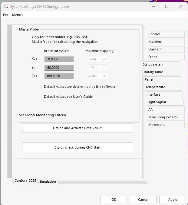

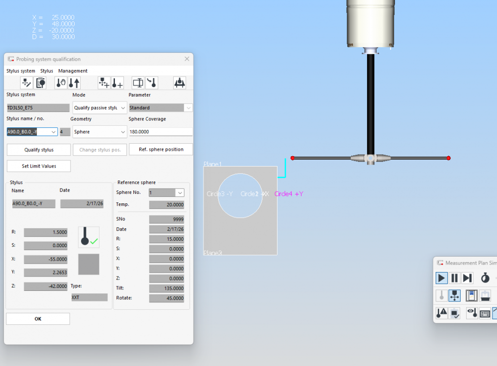

[Te...] Posted February 16 Share Posted February 16 (edited) These all look like set up issues with the RDS the offset is not correct The Z value may be different on older versions of Calypso but the X and -Ym should be the same no matter what Simulation is "working" again with service pack 2 still a little sluggish but usable Edited February 16 Link to comment https://qualityforum.zeiss.com/topic/25525-planner-im-tired-of-it-actual-state-in-80/#findComment-146243 Share on other sites More sharing options...

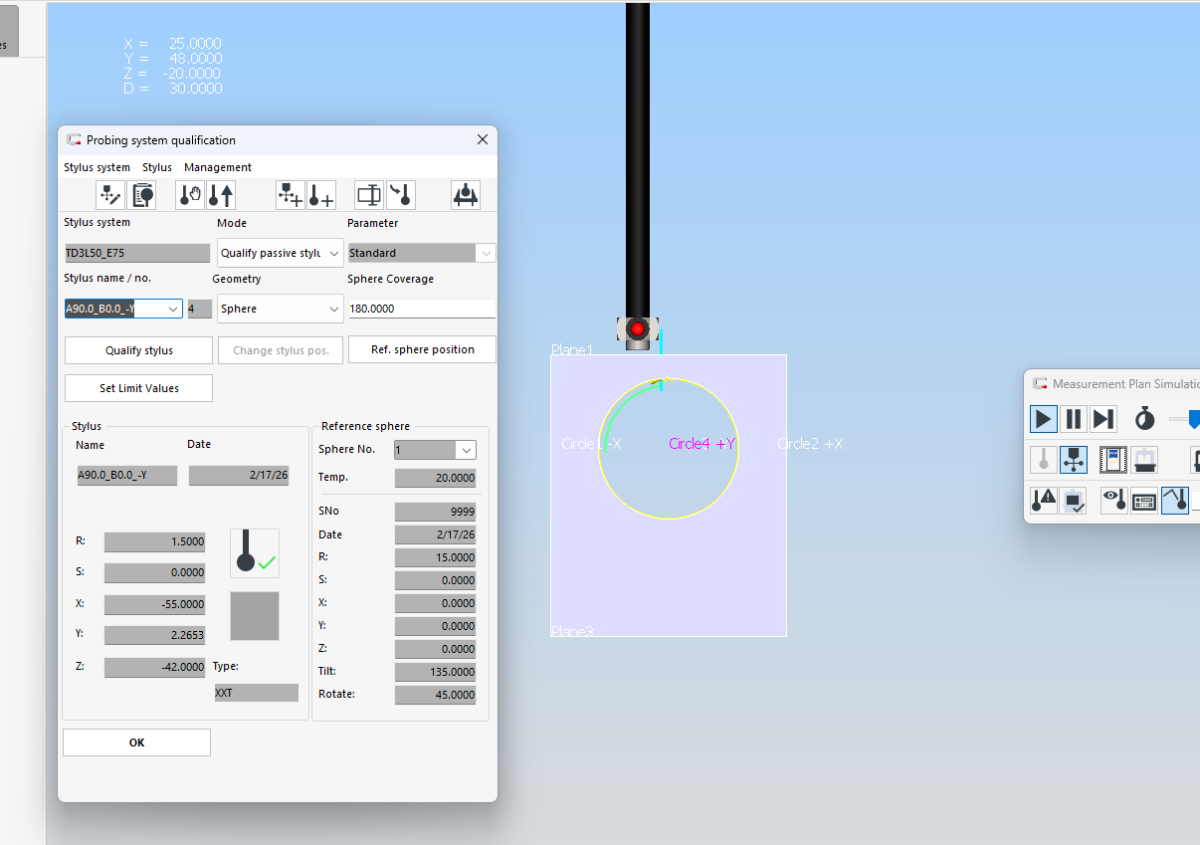

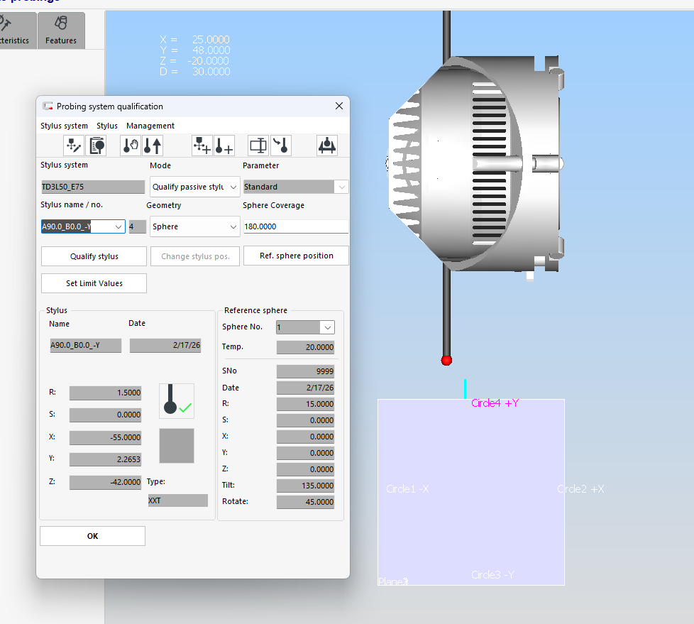

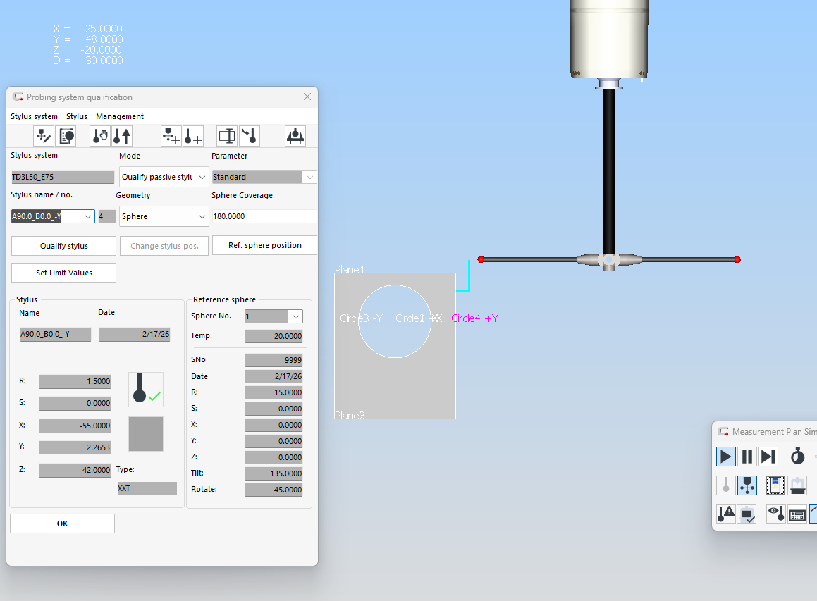

[Lu...] Posted February 17 Share Posted February 17 Hi all i have a issue with the RDS probe when i imported a new probe (T) probe. the position -X and +X same axis main configuration on Sytuls system creator works well. The issue is when i create new position on RDS to creante new probe position +Y and -Y, so i turned A90.0_B0.0 and create the new positions and update the probe file as usual the probe in simulation have strange offsets anyone have this issue?? i used the values show above for the master probe 0,60,188.102 and nothing works correctle when i add new positions in other probe files. Link to comment https://qualityforum.zeiss.com/topic/25525-planner-im-tired-of-it-actual-state-in-80/#findComment-146271 Share on other sites More sharing options...
