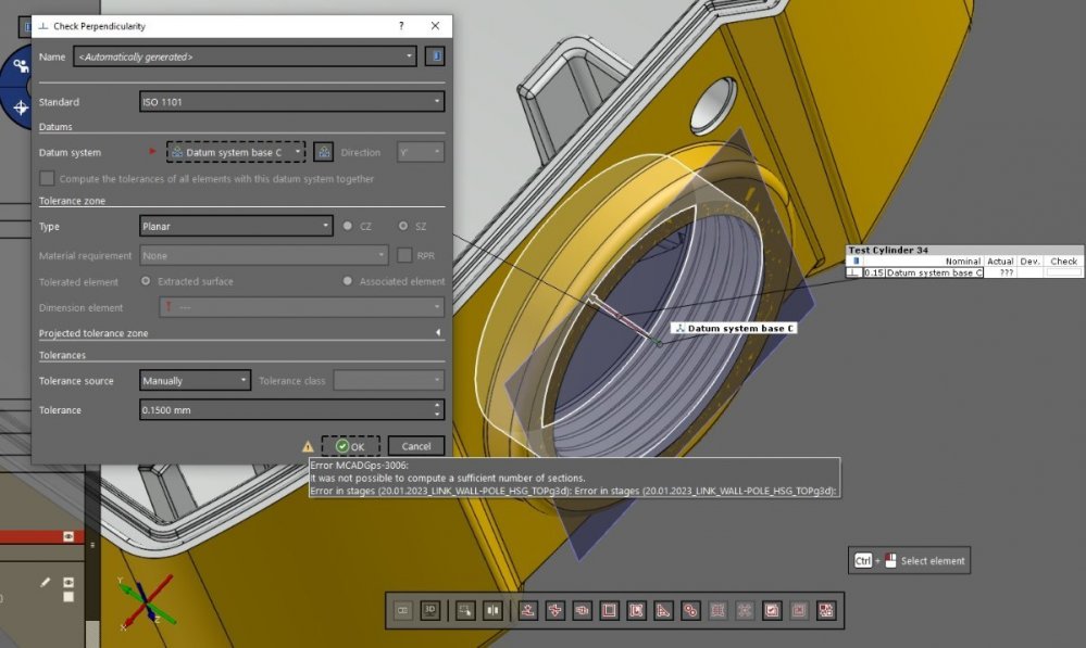

[Ro...] Posted February 5, 2024 Share Posted February 5, 2024 Hello, how could I measure the thread's perpendicularity to a base? Link to comment https://qualityforum.zeiss.com/topic/2554-thread-inspection-with-gom-software/#findComment-10326 Share on other sites More sharing options...
[Mi...] Posted February 5, 2024 Share Posted February 5, 2024 The software tries to construct at least three cylinder sections but may fail if the available actual data is insufficient. I assume you tried to construct a cylinder on a mesh in this example? You could try "edit creation (F4)" on the cylinder and have a look at the preview visualization. The selected parts of the mesh should be visible in red. If the selected red area is smaller than you expect, try to use the expert parameters in the selection cylinder dialog to increase your selection. E.g., it could be a good idea to set the angle to 90 degrees to ensure that the selection extends inside the ridges of the thread. Link to comment https://qualityforum.zeiss.com/topic/2554-thread-inspection-with-gom-software/#findComment-10328 Share on other sites More sharing options...
[Ja...] Posted February 5, 2024 Share Posted February 5, 2024 I would suggest ultimately the answer is once again adapters and measure the cylinder and perpendicularity of the inferred axis. I do not see you can get reliable result from trying to measure this directly and fitting cylinders to thread data Link to comment https://qualityforum.zeiss.com/topic/2554-thread-inspection-with-gom-software/#findComment-10332 Share on other sites More sharing options...
[Ch...] Posted February 6, 2024 Share Posted February 6, 2024 Correct, direct evaluation of thread data (at least for the GD&T section) is not (yet) supported. Due to the fact that you cannot evaluate GD&T on non fitting elements the only way (at the moment) should be 1) Using adapters to get a relieable cylinder axis. 2) Create at least 6 points on this axis in the area where do you want to evaluate your perpendicularity 3) Create a fitting line from these points 4) Evaluate your perpendicularity from this fitting line Yes we are aware that a solution out of the box would be nice. Christoph Schult Link to comment https://qualityforum.zeiss.com/topic/2554-thread-inspection-with-gom-software/#findComment-10336 Share on other sites More sharing options...
