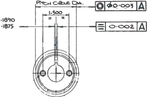

[ma...] Posted January 15 Share Posted January 15 I am trying to measure the Equidistance of two holes to the centre of a hole , I can calculate it by measuring each hole individually away from the centre in X+ & X- and taking the difference away from distance quite easily, measuring the Link to comment https://qualityforum.zeiss.com/topic/25561-equal-distance-of-hole-position/ Share on other sites More sharing options...
[Ma...] Posted January 15 Share Posted January 15 Just measure 2 individual circles/cylinders and make symmetry contruction from them. Then this symmetry use in symmetry callout. But you have symmetry calout only for a slot - which can be done by symmetry point or that construction described above, just with points. 1 Link to comment https://qualityforum.zeiss.com/topic/25561-equal-distance-of-hole-position/#findComment-144625 Share on other sites More sharing options...
