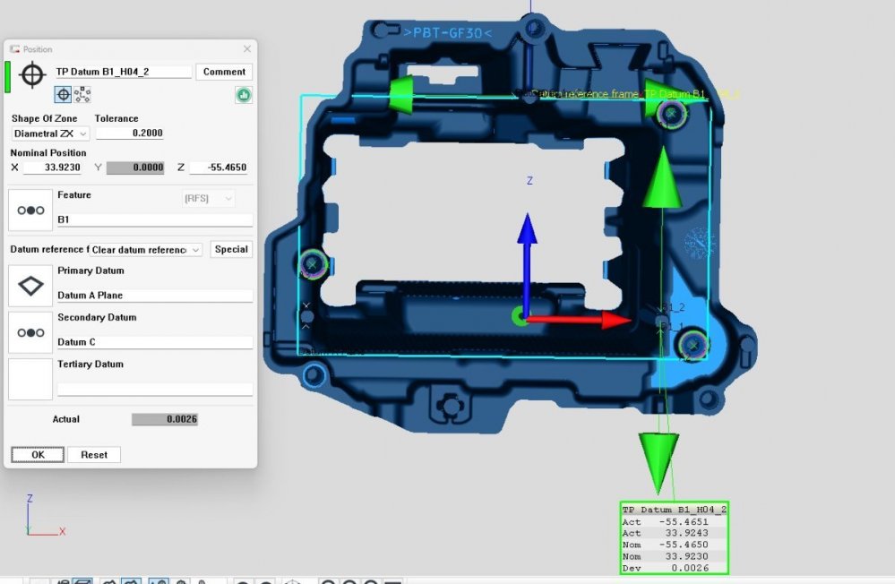

[Ma...] Posted January 15 Share Posted January 15 I am trying to figure out what my nominals would be if C was dimension back to A and B and B to A and C? I would think since B1 and B2 control rotation, you would only have one value in my case the Z distance from that B Datum the dimensioning Datum B to A and C...not sure. How would I set this up? Link to comment https://qualityforum.zeiss.com/topic/25565-tp-of-b-back-to-a-and-c/ Share on other sites More sharing options...

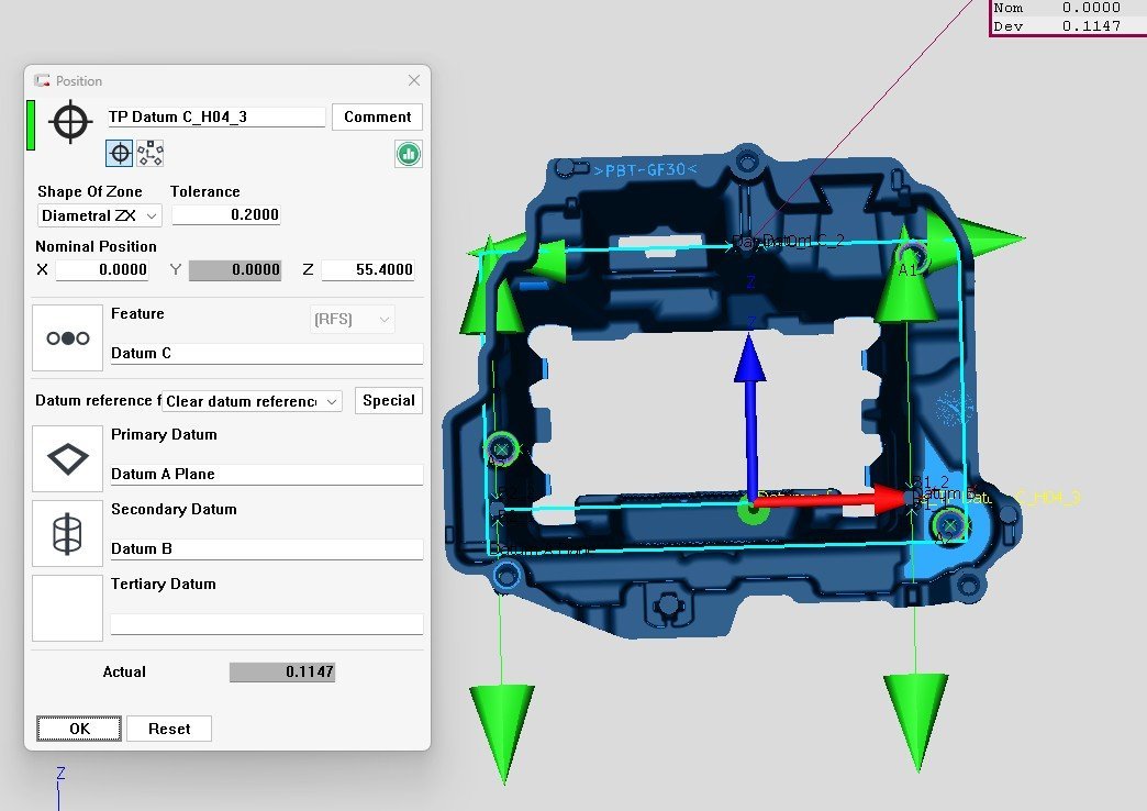

[Ma...] Posted January 15 Author Share Posted January 15 Yes for the call-out for Datum B to A/C yes, that one is pretty straightforward as far as pulling the nominal dimensions from C to B1 and B2, not sure how rotation is controlled but I get the idea two planes 90° (A and C) intersecting, so I got the X and Z nominals off of the Cad, but the C to AB is still a little odd, I would assume the same notion two 90° planes intersecting at A Plane and B Line but where is the origin in that? This is what I got but I question if its correct. Link to comment https://qualityforum.zeiss.com/topic/25565-tp-of-b-back-to-a-and-c/#findComment-144671 Share on other sites More sharing options...

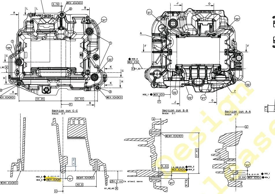

[Ma...] Posted January 15 Share Posted January 15 Those datums B and C - are they circles or how is looking their shape? If datum B is only symmetry of planes in Z, then you can not do TP for C and same for TP for B Link to comment https://qualityforum.zeiss.com/topic/25565-tp-of-b-back-to-a-and-c/#findComment-144673 Share on other sites More sharing options...

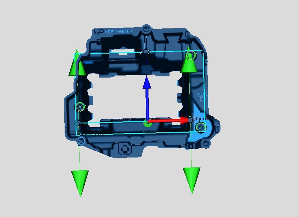

[Ma...] Posted January 15 Author Share Posted January 15 They are symmetry points and then a 3D line as they are a unique shape, can't really get a circle or cylinder off of them. Datum B1 and B2 are called back to A and C and Datum C is called back to AB, so I was thinking A and B intersect but you only get one direction as there is nothing controlling translation, for B back to AC, the origin is the intersecting planes of A and C but nothing really controlling rotation, I am using lines and points but as it was designed I am picturing the features as orthogonal planes. Does that make sense? Like in this example. I am not sure how else to set this call-out up and welcome any suggestions. Link to comment https://qualityforum.zeiss.com/topic/25565-tp-of-b-back-to-a-and-c/#findComment-144675 Share on other sites More sharing options...
[Ma...] Posted January 15 Share Posted January 15 For me is not making sense any of those TP. For C you would need to have only in X direction, which can not be given by datum B and for B's - they need controling in Z, but C is giving X. I would ask customer/engineer how they ment this to be measured. Link to comment https://qualityforum.zeiss.com/topic/25565-tp-of-b-back-to-a-and-c/#findComment-144679 Share on other sites More sharing options...

[Ma...] Posted January 23 Author Share Posted January 23 So if we did use circles would only get an X Value for TP of B1 back to AC? Two intersecting planes would only get an X value right? Link to comment https://qualityforum.zeiss.com/topic/25565-tp-of-b-back-to-a-and-c/#findComment-145035 Share on other sites More sharing options...
[Ma...] Posted January 24 Share Posted January 24 For that it should give you only one axis ( not sure which one in this case ) but the other axis should be fine, because it should rotate measured feature to nominal value. So if you have measured feature to be [X+20] and Y-20 ( X is base dimension ) then it should rotate to have X exactly X+20, then Y won't be exact -20 Link to comment https://qualityforum.zeiss.com/topic/25565-tp-of-b-back-to-a-and-c/#findComment-145041 Share on other sites More sharing options...
