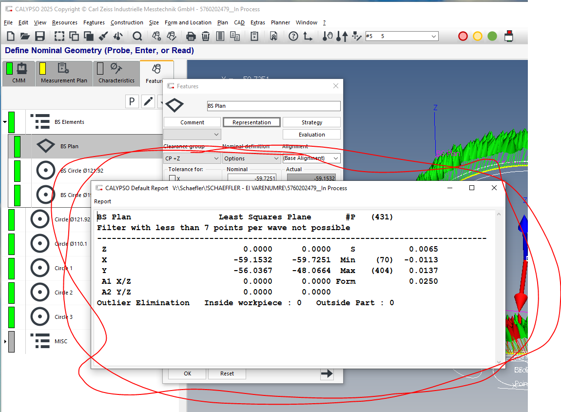

[Ke...] Posted January 16 Share Posted January 16 HI I'm new in this measurement world, so I hope You can help me with this. How do I turn of this Default Report? THX Kenneth Link to comment https://qualityforum.zeiss.com/topic/25573-turn-off-default-report/ Share on other sites More sharing options...
[Ma...] Posted January 16 Share Posted January 16 I wasn't successful with eliminating of showing this up, but once it's shown, you can just minimize it and it won't popup again. 1 Link to comment https://qualityforum.zeiss.com/topic/25573-turn-off-default-report/#findComment-144713 Share on other sites More sharing options...
[Ke...] Posted January 16 Author Share Posted January 16 THX Martin, it would just be nice, if it didn't show at all 😉 Link to comment https://qualityforum.zeiss.com/topic/25573-turn-off-default-report/#findComment-144715 Share on other sites More sharing options...
[No...] Posted January 16 Share Posted January 16 (edited) In old Calypso releases it was possible to hide it from the protocol settings. But then they made a change and now it keeps popping up. Edited January 16 1 Link to comment https://qualityforum.zeiss.com/topic/25573-turn-off-default-report/#findComment-144733 Share on other sites More sharing options...

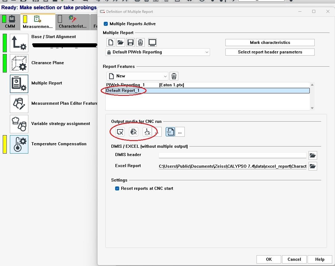

[Ri...] Posted January 16 Share Posted January 16 In v2022 this is what I do. Are others saying newer versions will not prevent this? 2 Link to comment https://qualityforum.zeiss.com/topic/25573-turn-off-default-report/#findComment-144735 Share on other sites More sharing options...
[Ma...] Posted January 16 Share Posted January 16 (edited) Please sign in to view this quote. Thanks - that seems to work - never thought about that. Everytime i've opened program and clicked on feature/characteristic then this window showed. I've tried out that and seems to work :-) ( Calypso 2024 ) Edited January 16 1 Link to comment https://qualityforum.zeiss.com/topic/25573-turn-off-default-report/#findComment-144737 Share on other sites More sharing options...
[Ri...] Posted January 16 Share Posted January 16 Please sign in to view this quote. I don't recall who showed me, may have been Tom. 1 Link to comment https://qualityforum.zeiss.com/topic/25573-turn-off-default-report/#findComment-144765 Share on other sites More sharing options...
