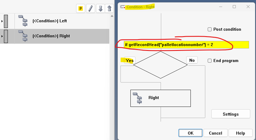

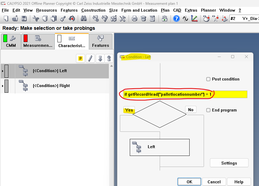

[Jo...] Posted January 27 Share Posted January 27 You may be able to accomplish this using the "Condition" function and groups. This should be available in the "Free" PCM of Calypso. Two characteristic sets ("Left" and "Right" ). Right click - Condition, uncheck post condition, add condition listed below. You may need two == signs, I can't remember. I have not tested if this works. You may need to change the run order to "From Characteristic list". 1 Link to comment https://qualityforum.zeiss.com/topic/25611-multiple-measurement-plans-how-to-start/#findComment-145145 Share on other sites More sharing options...
[Ma...] Posted January 27 Share Posted January 27 If you want to run pallet program with two nests, then Josephs idea with simple condition is fine. Only problem are names of characteristics - can not be same for both sides. I am not sure if you can select strategy via this simple nonlicense pcm option. But this can keep not doubled features and characteristics. Link to comment https://qualityforum.zeiss.com/topic/25611-multiple-measurement-plans-how-to-start/#findComment-145149 Share on other sites More sharing options...
