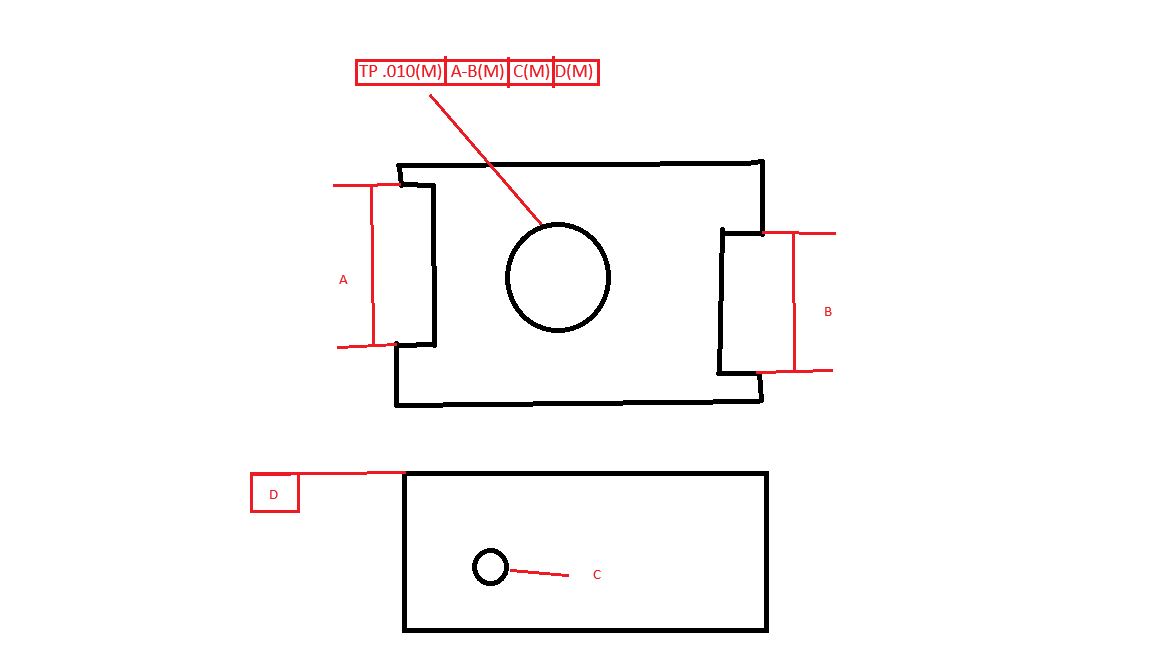

[Lu...] Posted January 27 Share Posted January 27 (edited) Hello, I am working with a print and I have never seen this type of true position callout, It is using a common datum between two slots that are offset from each other, with mmc. I drew a quick drawing of what I am seeing to make it easier to explain. Do I create a symmetry plane between the 2 centers of the slots? If so, how do I apply MMC to it? Any help is appreciated, thank you EDIT: just noticed i drew mmc for datum D, datum d does not have mmc that is my mistake Edited January 27 wrong mmc Link to comment https://qualityforum.zeiss.com/topic/25641-gdtcalypso-question/ Share on other sites More sharing options...
[Jo...] Posted January 27 Share Posted January 27 I get what they are trying to do, I'm not 100% sure if it's legal haha. Each slot on its own is a feature of size so MMC could be applied. Technically, the A-B plane is not a FOS, so MMC should not be applicable. I'm about 90% sure on this, but someone may be able to confirm this. Either way, the software doesn't allow for it with a symmetry plane. If you must have this, you may be able to add the bonus tolerance with PCM. If you right-click the true position tolerance box, you can add a formula to add the additional bonus. 2 Link to comment https://qualityforum.zeiss.com/topic/25641-gdtcalypso-question/#findComment-145115 Share on other sites More sharing options...
[Ke...] Posted January 27 Share Posted January 27 The way I understand it, MMC is only applied to the feature being evaluated for position... Datums get MMB which allows the part to "float" and does not actually add to the applied position tolerances 4 Link to comment https://qualityforum.zeiss.com/topic/25641-gdtcalypso-question/#findComment-145127 Share on other sites More sharing options...
[Ma...] Posted January 27 Share Posted January 27 I would rather see 2xTP for side slots with primary being middle big hole than this. I don't think there will be any way to get MMB on A-B. 1 Link to comment https://qualityforum.zeiss.com/topic/25641-gdtcalypso-question/#findComment-145151 Share on other sites More sharing options...
