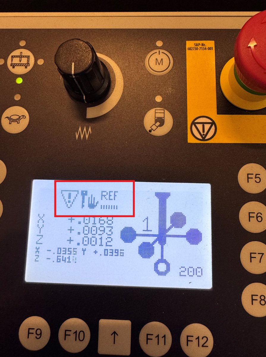

[Ma...] Posted January 27 Share Posted January 27 Hi, Recently, we have had multiple issues with the electrical power supply. After these problems, we are unable to start the drives on CMM Patient: CMM Zeiss Duramax On the control panel, the following message appears: His anyone has this problem beofore? Can I tak any actions on my own to try to start the drives? O would like to add that I have already tried moving head manually along each axis, so this is not a issue related to the machine hitting a limit switch at the moment of power outage Link to comment https://qualityforum.zeiss.com/topic/25649-lack-of-power-supply-and-problem-with-starting-the-drives/ Share on other sites More sharing options...
[Ma...] Posted January 27 Share Posted January 27 If it's same pictograms as for our Accura, then machine needs to get home position ( that's REF ) / key is indicating turned key for slower speeds. Exclamation mark would be indication of homing or not turned on drives. Have you tried turning machine completely off for a minute? Also i am holding drive button for a few secs ( on remote you must, on machine you can ) Link to comment https://qualityforum.zeiss.com/topic/25649-lack-of-power-supply-and-problem-with-starting-the-drives/#findComment-145155 Share on other sites More sharing options...
[Ma...] Posted January 27 Author Share Posted January 27 Please sign in to view this quote. I've been working on a CMM for a quite a few years and I never noticed that this pictogram refers to this operation 😄 Thanks Martin 🙂 Yes, I tried restarting CMM several times and also held the drives button, but it didn't help. We'll probably have to call service 1 Link to comment https://qualityforum.zeiss.com/topic/25649-lack-of-power-supply-and-problem-with-starting-the-drives/#findComment-145165 Share on other sites More sharing options...
[No...] Posted January 28 Share Posted January 28 Sounds stupid, but have you checked the emergency stop button? Don't laugh! Many years ago I had similar issues and was close to calling the service when finally I noticed the emergency stop was enabled. I had pressed it myself accidentally with my belly when leaning over the machine. 🤭 Ok, laugh. 🙄 Link to comment https://qualityforum.zeiss.com/topic/25649-lack-of-power-supply-and-problem-with-starting-the-drives/#findComment-145217 Share on other sites More sharing options...
