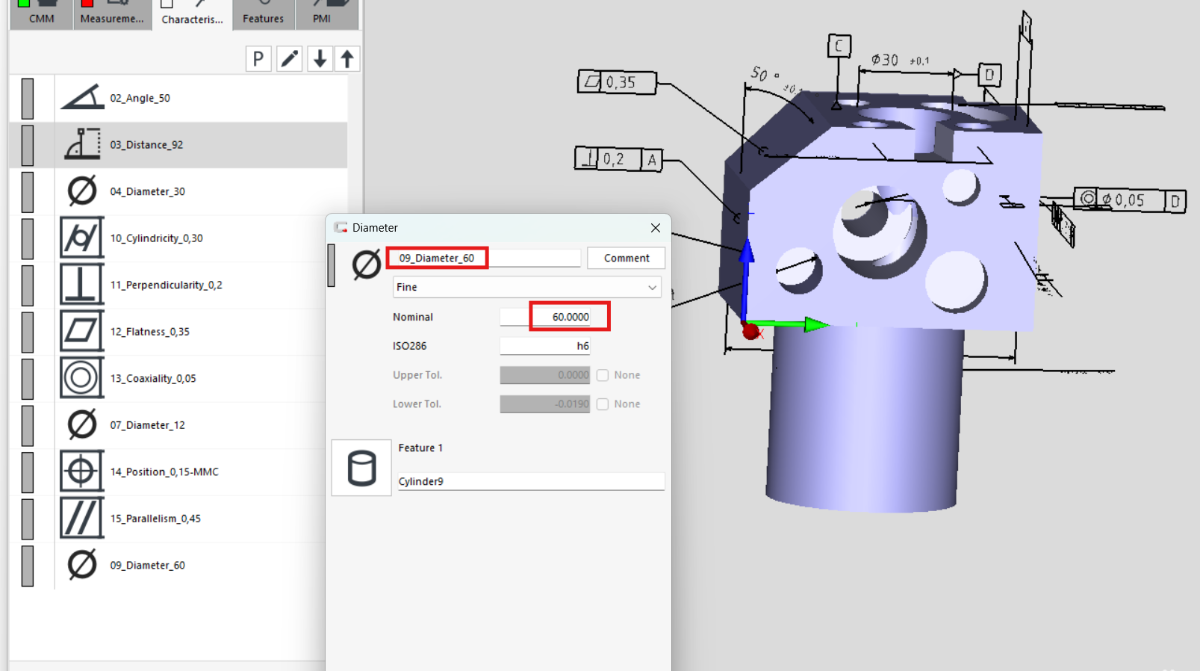

[An...] Posted February 20 Share Posted February 20 Might not be the directly related to your question but playing with PMI models just now and the auto generate function, it does look like the characteristics do what you are wanting. But unfortunately not on the feature side, and I think because a feature can have many call outs so it might not know which specific one you would want to base the name on. Link to comment https://qualityforum.zeiss.com/topic/25667-automatic-feature-naming/#findComment-146469 Share on other sites More sharing options...
