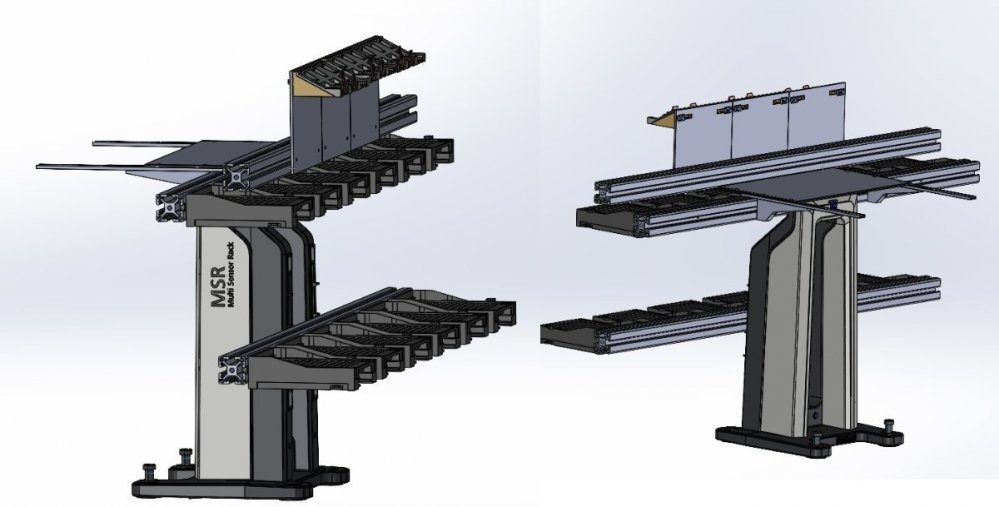

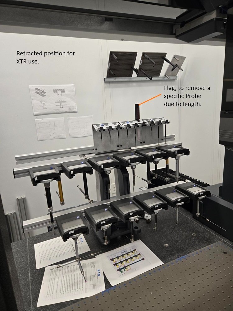

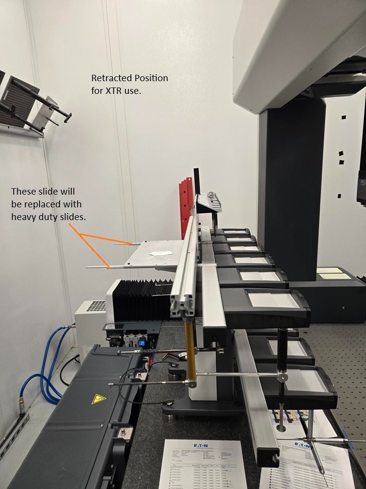

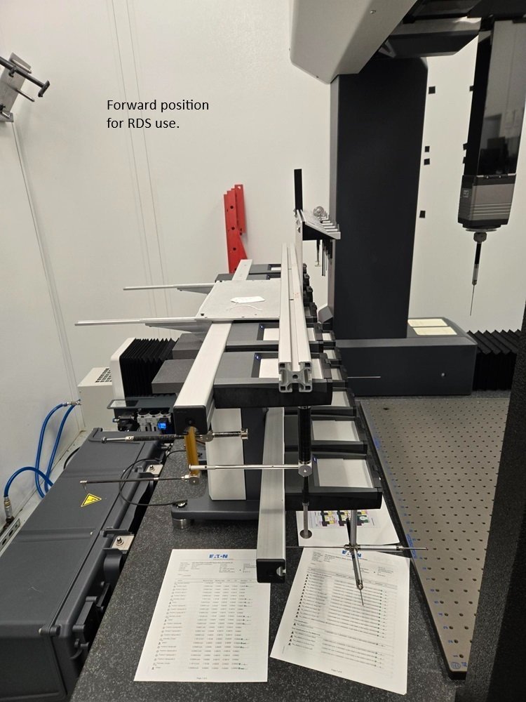

[Ri...] Posted January 29 Share Posted January 29 I posted this once before. This is the CAD model setup; it has been functional for about 6 months now? The XXT setup at the top is manually moved into place for RDS XXT operation and manually returned for XTR operation. Only takes a minute to move and use. Setup on a Contura 2014 size 9/12/6 1 1 Link to comment https://qualityforum.zeiss.com/topic/25683-msr-20-looks-impressive/#findComment-145301 Share on other sites More sharing options...

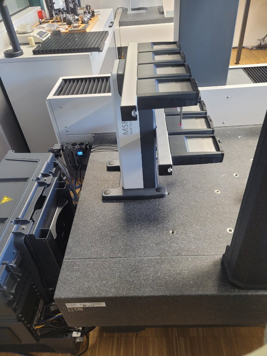

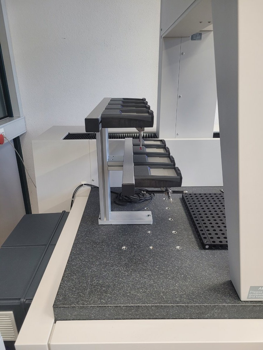

[Je...] Posted January 30 Share Posted January 30 (edited) I have a MSR 2.0 on my newer Micura, and I can’t recommend it. The MSR 2.0 takes up about 150mm of measuring space in the y-axis compared to the MSR 1.0 Edited January 30 1 Link to comment https://qualityforum.zeiss.com/topic/25683-msr-20-looks-impressive/#findComment-145321 Share on other sites More sharing options...
[Ri...] Posted January 30 Share Posted January 30 Please sign in to view this quote. The only thing I think that should be changed is having the ability to adjust rack height (Especially the top rack), it is currently fixed for each height. Other than that, I currently have 6 probe holders on the top rack and 6 on the bottom rack and room to make the total count 7x7. That is a descent amount of probe holders. The MSR2.0 gets two thumbs up. 1 Link to comment https://qualityforum.zeiss.com/topic/25683-msr-20-looks-impressive/#findComment-145325 Share on other sites More sharing options...

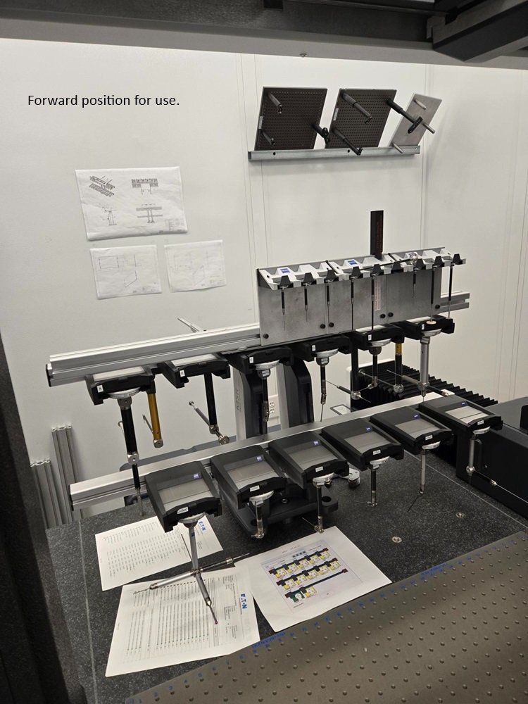

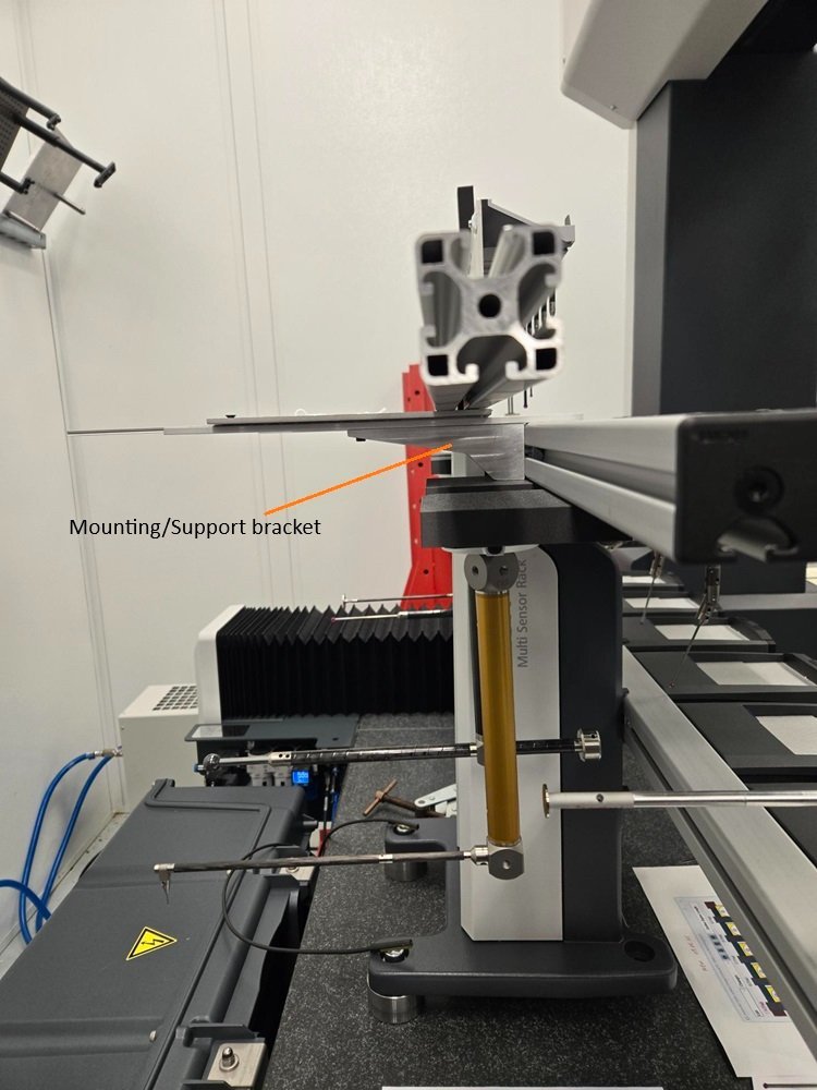

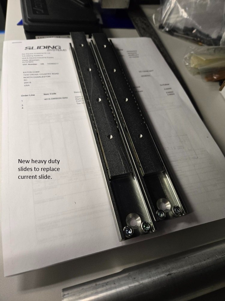

[Ri...] Posted January 30 Share Posted January 30 Actual images. 3 Link to comment https://qualityforum.zeiss.com/topic/25683-msr-20-looks-impressive/#findComment-145331 Share on other sites More sharing options...

[To...] Posted January 30 Share Posted January 30 (edited) Please sign in to view this quote. How new is your Micura? I believe the newer machines come with mounting holes in the granite that optimize the position of MSR 2.0. Edited January 30 2 Link to comment https://qualityforum.zeiss.com/topic/25683-msr-20-looks-impressive/#findComment-145339 Share on other sites More sharing options...

[Ri...] Posted January 30 Share Posted January 30 Please sign in to view this quote. I had to create 1-inch Risers for the MSR 2.0 due to the use of a giant Rayco plate. 2 Link to comment https://qualityforum.zeiss.com/topic/25683-msr-20-looks-impressive/#findComment-145351 Share on other sites More sharing options...

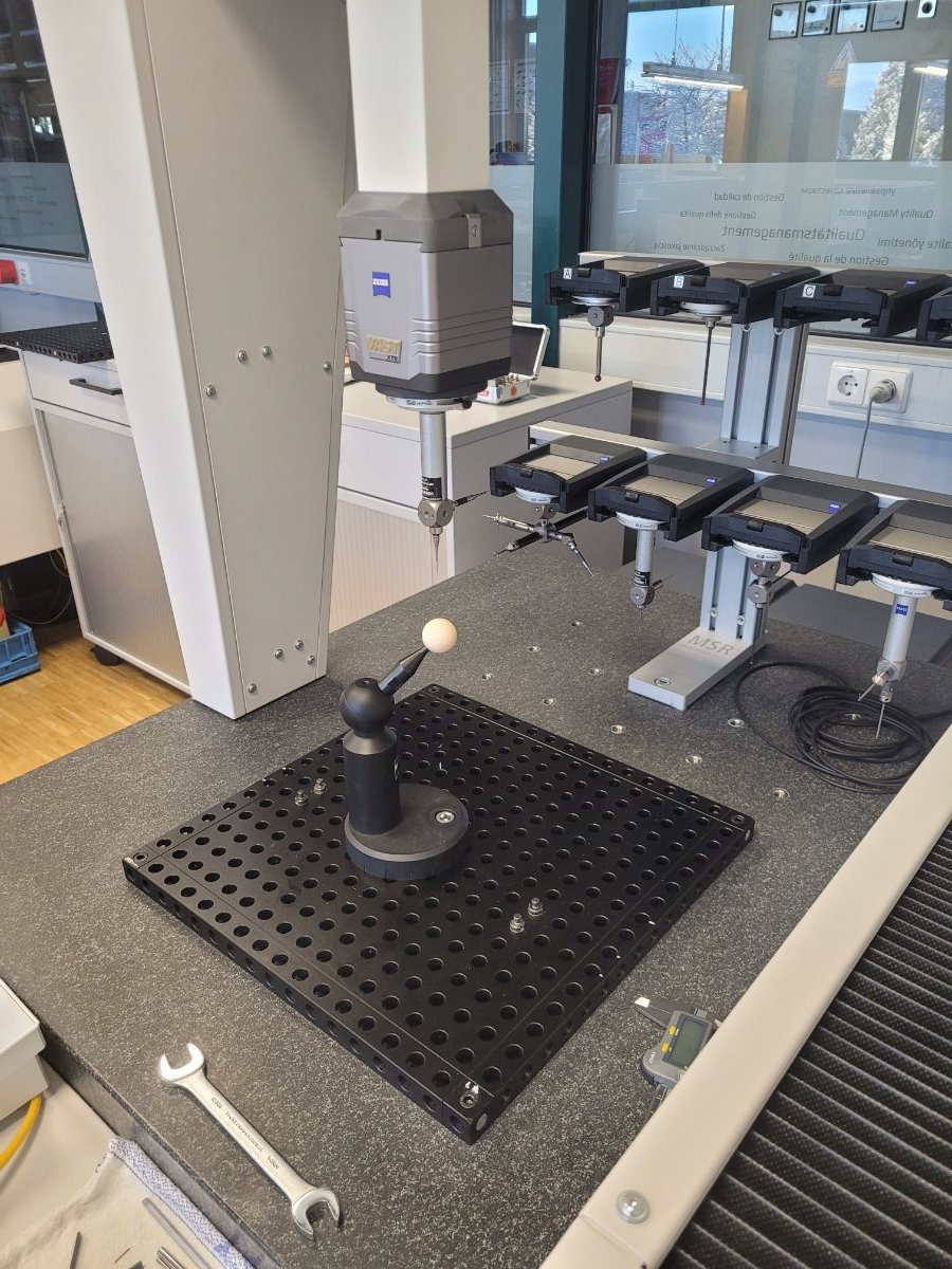

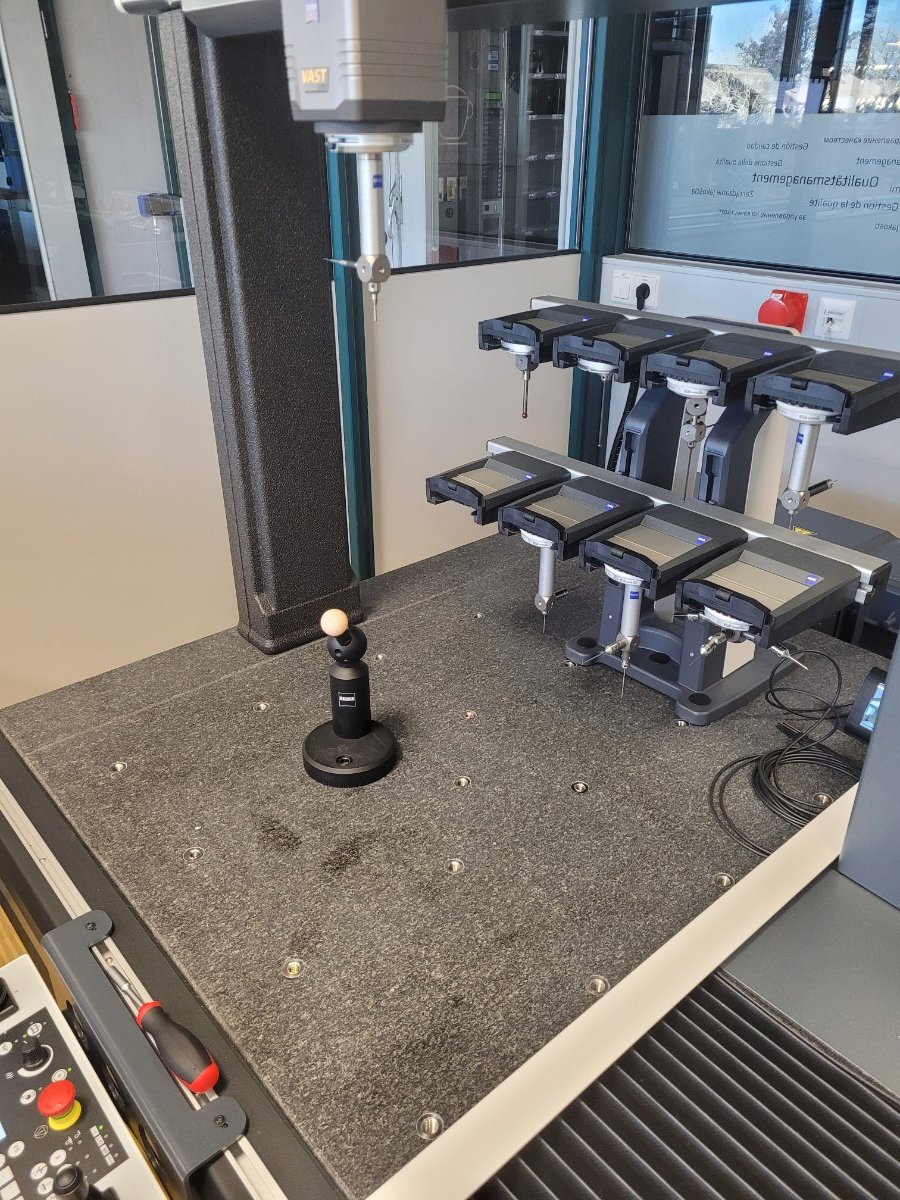

[Je...] Posted January 31 Share Posted January 31 (edited) Please sign in to view this quote. It´s about 2 years, it is the newest version (576), and maybe thats a part of the problem. Not sure, if you can see the difference at the pictures: Edited January 31 2 Link to comment https://qualityforum.zeiss.com/topic/25683-msr-20-looks-impressive/#findComment-145405 Share on other sites More sharing options...
[Je...] Posted January 31 Share Posted January 31 Please sign in to view this quote. you´re right, I´m creating a CAD-model for a adapter plate (to get more space in y at the newer Micura) right now, while the calibration programs are running 2 Link to comment https://qualityforum.zeiss.com/topic/25683-msr-20-looks-impressive/#findComment-145407 Share on other sites More sharing options...
