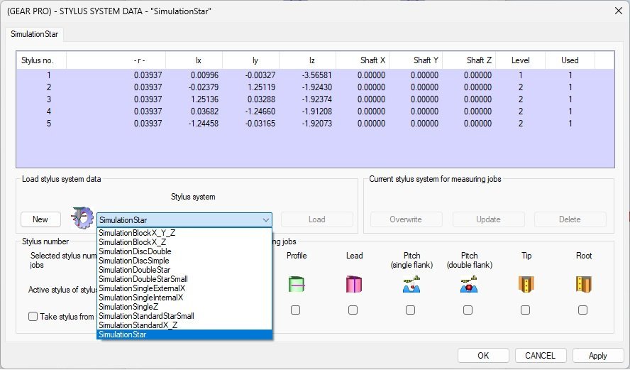

[Do...] Posted January 29 Share Posted January 29 Hi everyone. I am just starting out in GEAR PRO and am currently working from an offline station. I have all of my stylus systems loaded through CALYPSO, however, I do not see any of them listed within GEAR PRO. Is there an additional step needed to bring them over? Thank you in advance. Link to comment https://qualityforum.zeiss.com/topic/25685-gear-pro-stylus-system-selection/ Share on other sites More sharing options...

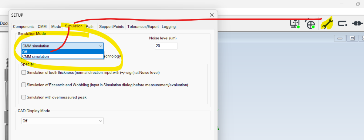

[Ro...] Posted January 30 Share Posted January 30 Hi, you have to create a simulation CMM in CALYPSO (I guess you already did this). After that you have to start GEAR PRO from the CALYPSO toolbar. In the Setup of GEAR PRO you have to select "Simulation Mode" => "Off". Using "CMM simulation" means a simulation without a virtual CALYPSO CMM, just pure GEAR PRO without any link to CALYPSO. Link to comment https://qualityforum.zeiss.com/topic/25685-gear-pro-stylus-system-selection/#findComment-145317 Share on other sites More sharing options...
[Do...] Posted January 30 Author Share Posted January 30 Roman, thank you! I had been stuck on that issue for the past week and would never have guessed to try that. Thanks again! Link to comment https://qualityforum.zeiss.com/topic/25685-gear-pro-stylus-system-selection/#findComment-145347 Share on other sites More sharing options...
