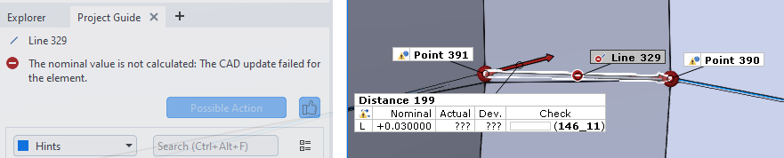

[DJ...] Posted January 30 Share Posted January 30 Good Morning/Evening and happy Friday! 😀 I am currently running into an issue with only four lines on four chamfers on a project that seem to have the same error. I am picking up enough points (26) and the CAD has not changed. The mesh is fully intact and has scanned adequately. The most I can find on this subject is that it is a CAD issue. Any other information related to this issue would be greatly appreciated :). Kind Regards, -D Yager Link to comment https://qualityforum.zeiss.com/topic/25687-the-nominal-value-is-not-calculated-the-cad-update-failed-for-the-element/ Share on other sites More sharing options...
[Jo...] Posted January 30 Share Posted January 30 (edited) Looks like a subsequent fault. Which element is based of what? What is your build sequence? There are yellow attention signs on the points, so if they are used to build line 329 you should solve the problems with the points first. If not why is the line not on the chamfer but connecting the points? Â Â Â Edited January 30 Link to comment https://qualityforum.zeiss.com/topic/25687-the-nominal-value-is-not-calculated-the-cad-update-failed-for-the-element/#findComment-145341 Share on other sites More sharing options...
