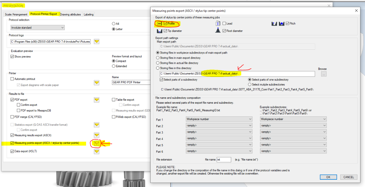

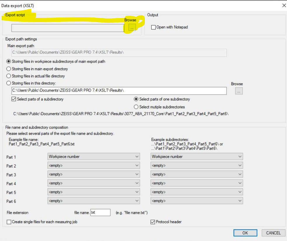

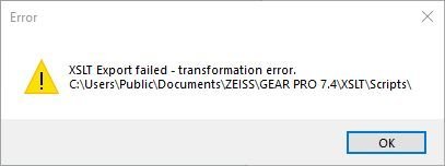

[He...] Posted January 30 Share Posted January 30 I am having problems with my Gear Pro 2025 software. I want to export my points I just measured for CTT, OD, and RD in a format that I can put into Solidworks. But I have been having nothing but problems with it. I do NOT know how to write script. I wouldn't even know where to put it. For a 13 Tooth gear, it barely showed me any data for each tooth on the report itself. If I could get an XYZ, TXT, excel, anything, would be helpful. Ever since I upgraded, it stinks. If someone would be kind to walk me through this process, I would be so grateful. Message me. I can give you my email. Please. People mention a clouds, and I have no clue what that is. Our company is strict on connecting the Zeiss to the internet or network for security reasons. I just want it to work correctly. I am hoping someone can help me. Thank you. Link to comment https://qualityforum.zeiss.com/topic/25695-data-export-script-error/ Share on other sites More sharing options...
[He...] Posted January 30 Author Share Posted January 30 Since those scripts are not working, I found this. Link to comment https://qualityforum.zeiss.com/topic/25695-data-export-script-error/#findComment-145383 Share on other sites More sharing options...
[Ro...] Posted February 2 Share Posted February 2 You have to select an export script, otherwise it can´t work 😉 A detailed description of the XSLT export formats you can find in the user manual. Link to comment https://qualityforum.zeiss.com/topic/25695-data-export-script-error/#findComment-145427 Share on other sites More sharing options...
